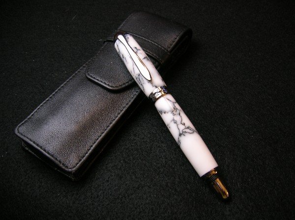

The Sedona. Has a very elegant feel in the hand and the round top/bottom is nice. I like the way the writing nib has "facets" on it, very unlike the Jr Gents of Craft Supplies-- that and the Sedona is a tad smaller.
Here is a pic of a Sedona in "Blanco Nero" trustone. This one is a fountain pen but it looks the same as the rollerball (well, until you remove the cap, lol).
