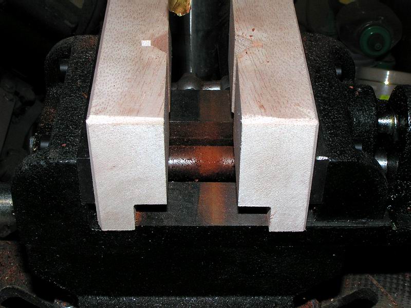

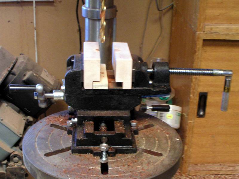

I use a drill press wirth a couple floating wooden jaws for drilling and squaring blanks and a wood vice to press the assembly.... it all lgoes pretty quic and accuratly... Do you really need a penpress/jig?
Im a newbie but things move along quick with what I have.
BIGSHED'S PICTURES BELOW IS JUST LIKE MY SET UP EXCEPT THAT MY VCUT WOODEN JAWS ARE NOT FASTENED TO THE VISE, I JUST LET MINE FLOAT AND THEY ACTUALLY CENTER THE BLANK AND MY VISE IS NOT LOCKED DOWN EITHER,I JUST POSITION ON CENTER UNDER BIT AND HOLD WITH LEFT HAND WHILE ADVANCING QUILL WITH RIGHT.... WORKS GREAT.

I adapted a cheap drill press stand for a hand drill to use as a pen press, see post #4 in this thread.
For drilling the blanks I use a cross slde drill press vise with wooden jaws with a V cut in them. I have some pictures somewhere, will try to find them.
