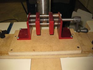

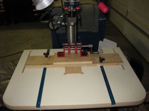

I made a jig for the Paul Huffman Vise to fit onto my drill press table. It can slide left/right a bit by loosening the knobs, and forward/back in the tracks. I made it with this adjustment so I could raise/lower the table and still have the ability to put a center punch rod in the drill press, then drop it into the vise, spin the vise knob to clamp the rod, then tighten down the jig to the table for perfect centering.
