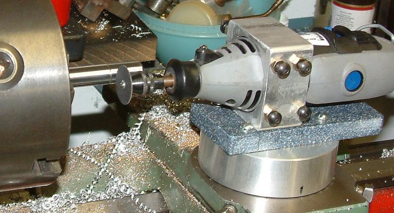

This was my best method for cutting brass tubes using my dremel with the black cut off disks shown in this pic cutting a groove in tool steel for a circlip.
Quite accidentally I used a small three wheeler band saw with a metal cutting blade it is by far and away the easiest cutting method for me, I use a cartridge reamer (all gun stores) it has an inside and an outside function to clean the cut.
Kind regards Peter.

Bob,
Kind regards Peter.
WOW Peter, that is one fantastic elaborate set up. Nice job!
