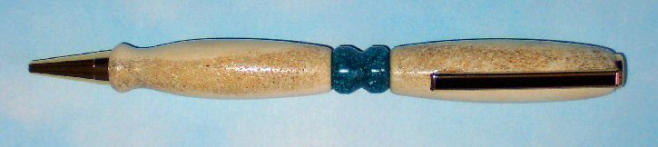

This is what I came up with for a girl at work who has Arthritis in her hands and she absolutely loved it . I added the lip at the bottom of the pen . No more pen slipping down and you don't have to apply any more pressure to the pen .

That's more like what I had in mind. I guess I need to run a few ideas by her. I told her that I have had other customers who were pleased with a pen that had a larger body. I'll send her some pictures and let her think about it.
