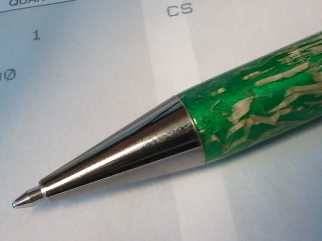

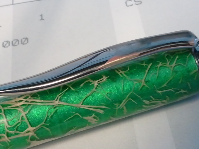

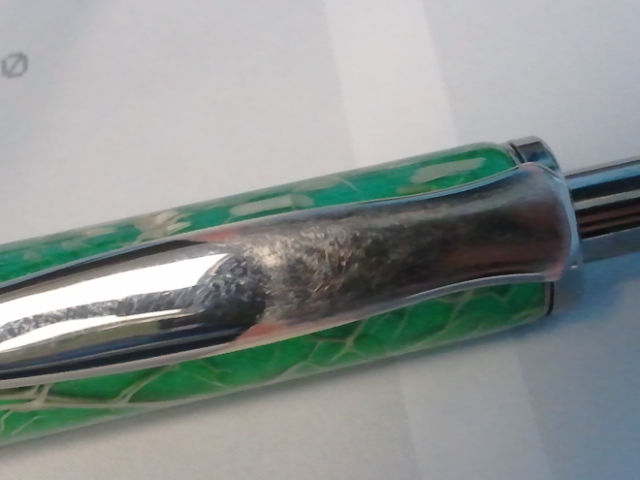

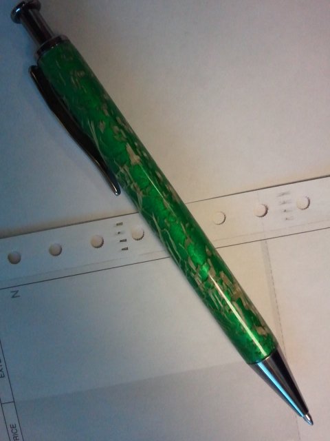

here is my pen after some serious use, clicker works flawlessly! But I'm not gentle on my pens, so the Blk Ti plating is wearing off on the clip from alot of desk use..But notice the nib picture, less wear, so overall a solid kit!

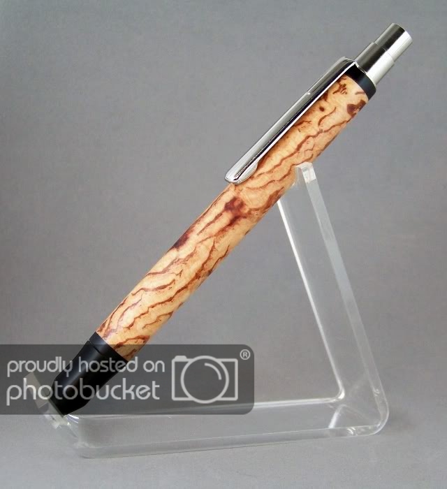

Well, as long as we're showing clickers, I might as well show the tru-quarter premier clicker.
I made this for my Dad who's from Montana. It has the Montana state quarter & the Glacier park quarter. I would never have invested this much in a blank to give my Dad if I wasn't happy with the click mechanism.
I also made my pith pen using a clicker.

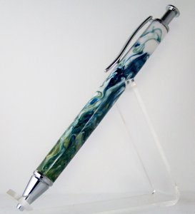

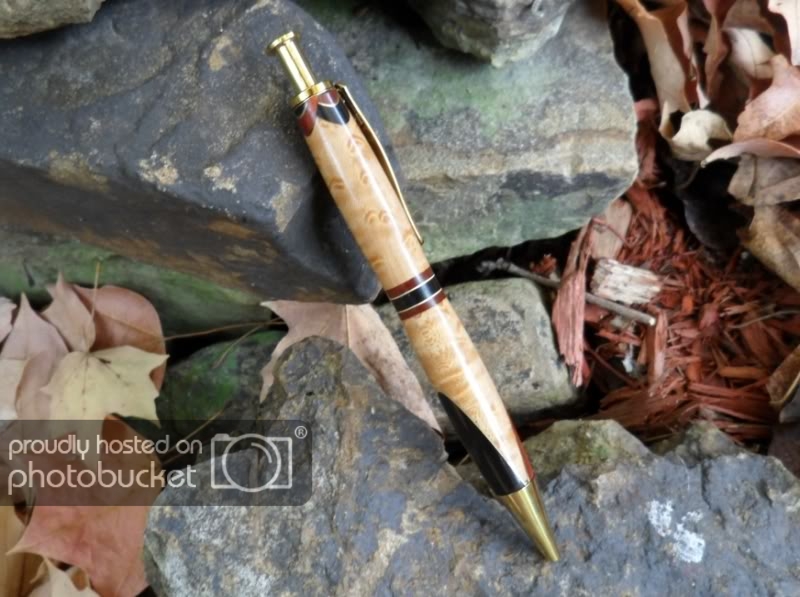

The long click was my fav until I started making my own kitless clicks:
The click mech is silkly smooth and QUIET. It's 100% metal so it won't break like the cheap plastic ones. The only spring is the one on the refill. You can adapt it in whatever fashion you want.
Wow!:eek: I like those. Too cool.
In response to the OP, CSUSA long clicker is the only click I'll do anymore.

Not mine, just quoting Brooks803's post. They really are imressive though, right?
Im curious about the mech as well.....
edit:(my mistake, he's Jon too)

He got the mech from Richard Greenwald. I just got some in and I am hoping for some shop time this afternoon ;)
thanks Hans, yes I get them from Richard Greenwald (google the name to get his site....I can't find my link). I'm hoping to finally get some shop time after this weekend!
