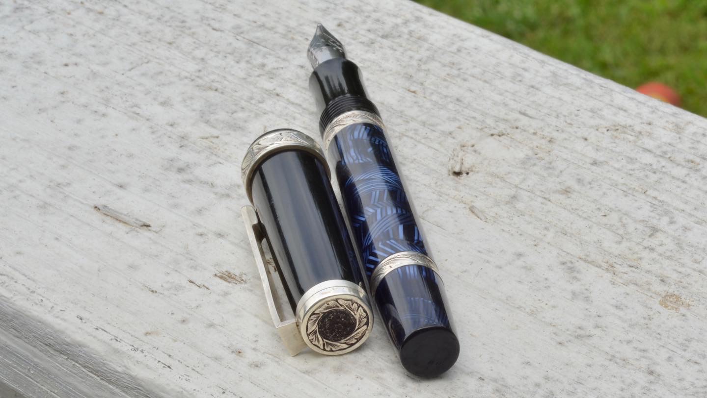

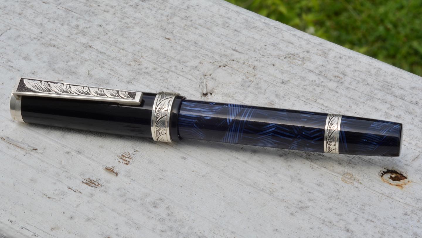

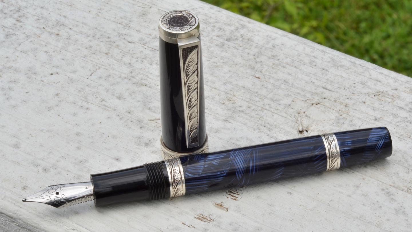

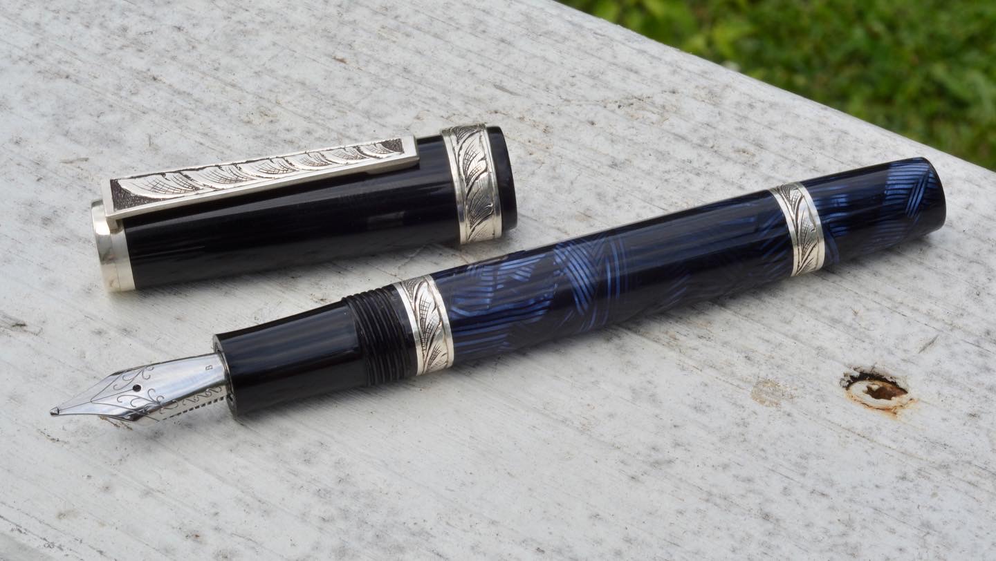

I was able to get my new shop set up to a rudimentary state of penmaking capability (I.e. one lathe and a light running off an extension cord from the house), so this is my first pen in several months. I made it from vintage blue lined cellulose acetate, black acrylic, and argentium silver. I saw some neat examples of vintage pens with large engraved barrel bands at the DC pen show, so I thought it would be fun to try something in a similar vein. I engraved a running leaf style border on all the trim. It uses a 12.5mm cap thread and is just shy of 5" capped. It is threaded for a jowo 6 nib.

Not a critique really, overall the finished pen is stunning, but I'm not convinced by the center part of the cap finial. That dark area seems doesn't belong there.

Beautiful. I understand Fred B's comments, but actually like the subtle appearance of the Cabachon center. And for the 'B' word... to me it is a reference that will fade in the wind as all useless fads. Sounds just silly and cliche.

Background removal made the leaves pop more than leaving it polished. I enjoy "bespoke " just for the amount of hate it gets from people on here.

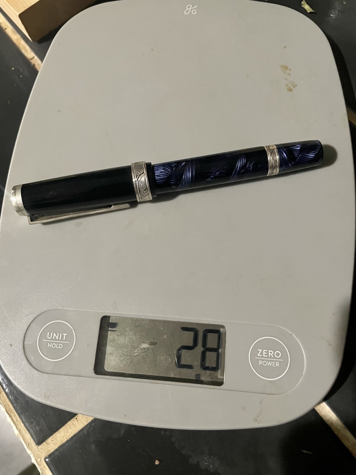

I'm curious what it weighs?

Yes, I agree. Bespoke is not particularly applicable here, but the rage it elicits from people makes me laugh.
Looking at 28g
