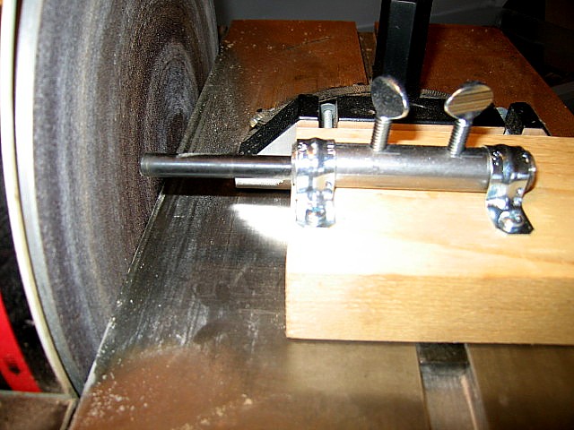

My squaring jig
This is my jig... the advantage is the removable rod.... the rods are actually transfer punches from Harbor Freight, $9.90 for the set and you end up with a pen dis-assembly set in the deal.
http://woodhelp.com/Jigs.htm#SquaringJig2
