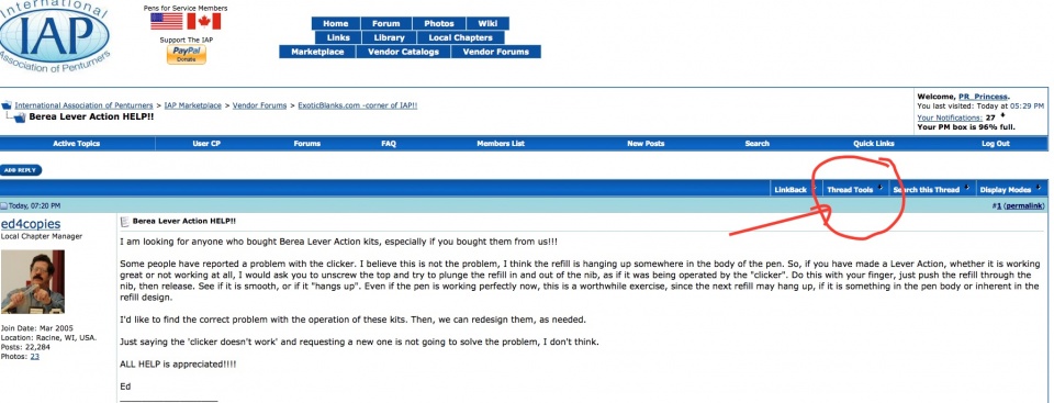

No answer but I want to follow this thread so I am replying...it's the only way I suscribe to a thread...I suspect there's another way that I don't know.
Yep, here ya go Smitty!:)
attachment.php
From the thread tools on the blue bar, select "Subscribe to this thread" on the drop down. It will then take you to an area in your user control panel where you can select notification options and then when done, hit the subscribe to the thread button.
Not hard, but VERY well hidden!!
BTW This was only to answer your (and possibly other new members) question on thread subscriptions. PLEASE continue posting here Smitty!!!
