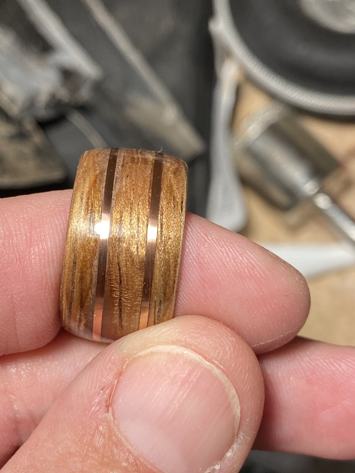

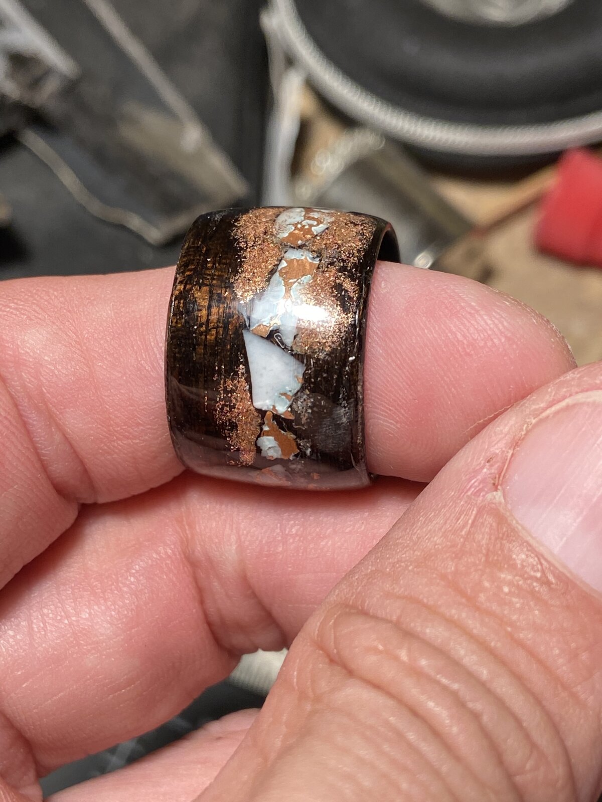

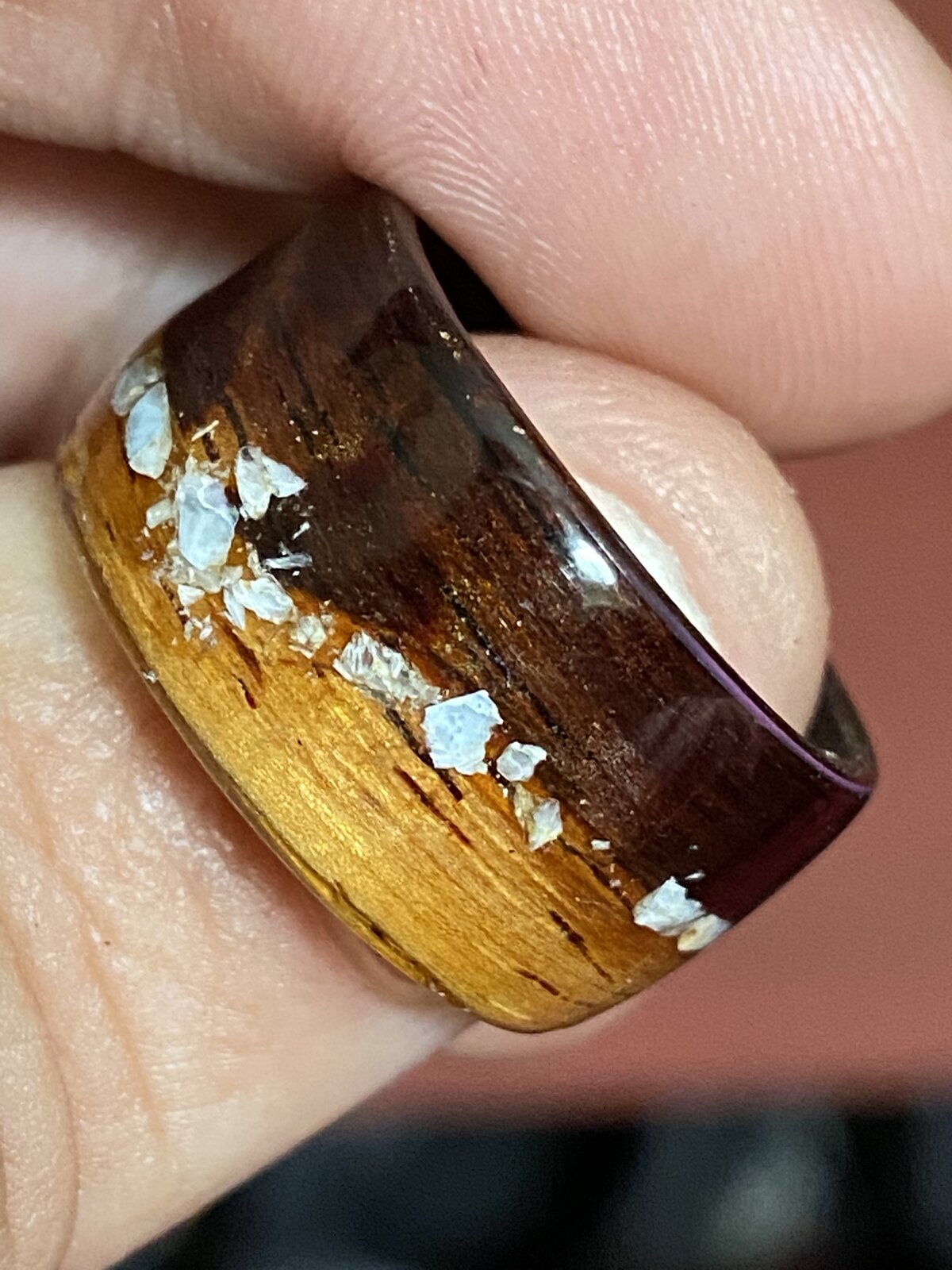

I purchased a little metal lathe several months ago and it really was to small for a good pen set up but was great for some of the detail turning on rings.
Please don't say that. I've got a tiny (like, probably-small-enough-to-fit-between-centers-on-my-midi tiny) little Taig micro lathe that's about to become my primary pen lathe - and probably my only machine tool, without driving an hour to my main shop.
The rings are gorgeous. Am I right in assuming you made the bent wood form, glued stone chips to it, sealed them in with CA (or resin?), and then machined everything flat?

That is it. I did all the bending and then put it on the lathe to get it to the thickness I wanted and to shape it a bit. Also great for cutting channels for the inlay.
