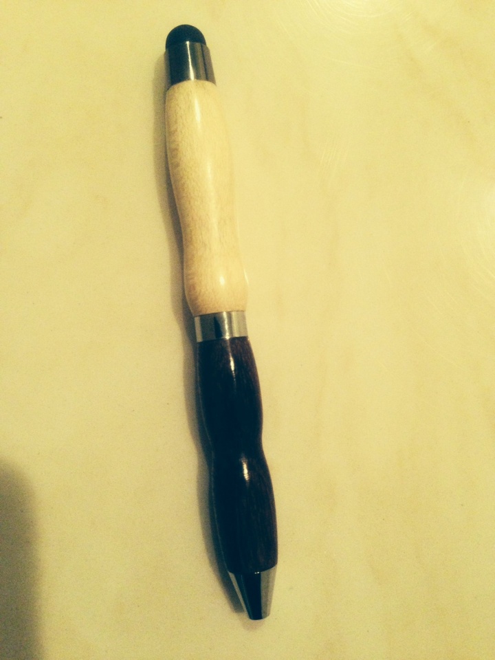

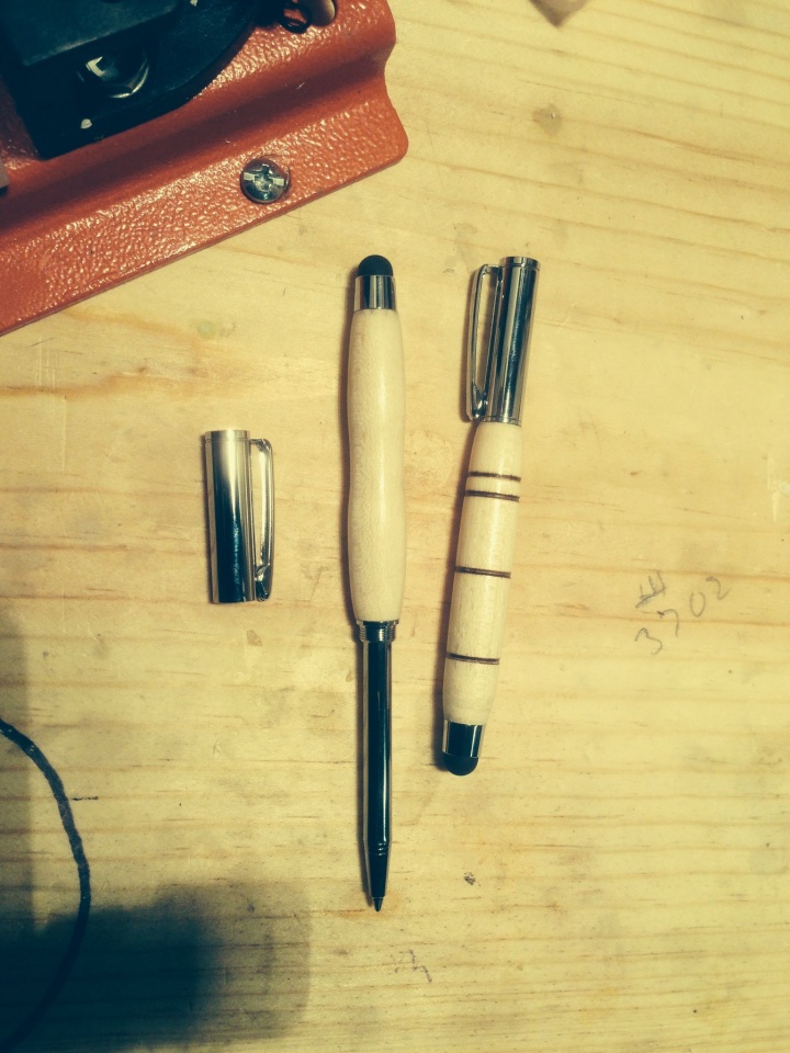

Be creative and drill. I used maple from a pool cue shaft.
