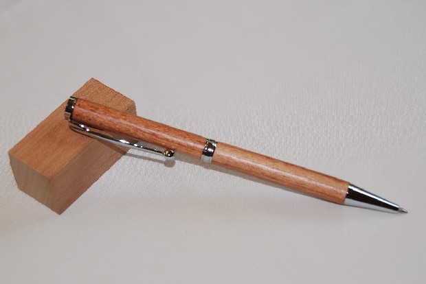

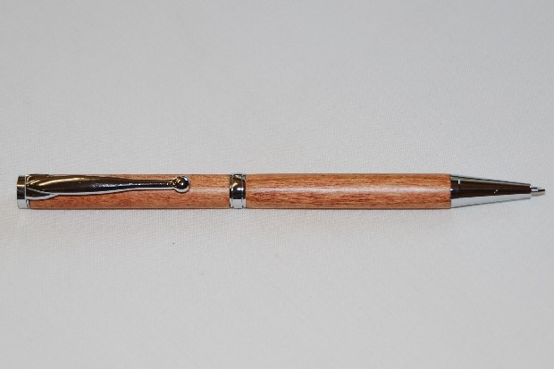

Well, I took the plunge! Got my first kits and a few other supplies the end of last week. Kept busy on other things over the weekend with LOML, but finally tried my first pen today. I rescued a piece of cherry from the smoker bin, cut it to size and drilled it to make the two blanks for a slimline. So far, so good!
I had bought an adjustable mandrel and had mounted it on my lathe. I glued a spare set of tubes in my blanks, mounted them on the mandrel and pretended I knew what I was doing! :rolleyes:
Anyway, so it took me the better part of an hour! I got 'er done -- sorta. I don't yet have some of the finishing supplies I've read about on here, so I used a process I've used on other woodworking projects: several coats of shellac with a drop of TT Red Mahogany dye after sanding to 400 grit. Worked up to 600 grit with the coats of shellac. Not having anything else on hand, I applied a few coats of Johnson's Wax, working it with 1000 grit and grocery bag paper until I got a nice sheen.
I promise! First pen ever. Didn't blow up anything. Like I said in the title: Beginner's Luck. I'll probably blow up the next ten attempts! :eek:
OK, so here are the requisite photos. No fancy photo booth yet, but I've got a new lighting kit on order.

Very nice job. Be sure to keep this one in a safe place. It's always nice to go back to that first one just to see how far you have come. Looking forward to seeing more of your pens as you progress in this wonderful hobby.

Bill, it looks like you hit your transitions to the metal parts dead on congratulations, as far as finishing materials just use straight CA glue, you may have to practice a bit, but it's about the most durable finish around, and gets an incredible gloss, But ya done good on the first try.

Nice Fit on your 1st pen!!! Very impressive. Never tried a slimline pen but I still have my 1st pen, a Euro Roundtop. Your Fit and finish is far superior to mine! Mine looked like a tree branch with an ink refill ;). Again, nice work!
