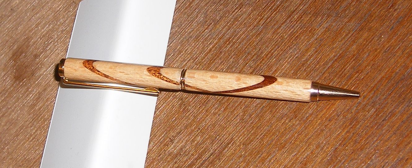

So, I'd squared off a few blanks and I had a strip of mahogany left over about 2mm wide. "What can I do with this?"
Well, the answer is to slice a piece of beech diagnally and glue the mahogany in between. Then do it again the same direction, then again in the diagonally opposite direction. Voila! Inlaid blank to turn.
This is what this pen shold have been.

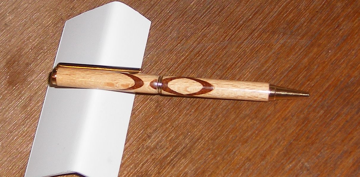

...and from another angle...
This is pen number 9. Get ready for 10. It's a biggie.
KDM
Nov 12, 2009
618
Redditch, England
Very nice!
My only suggestion would be to leave the segments away from the center band.
Yeah. I agree. I had to learn the hard way, though!! That's me all over!
Next time, I'll either make a bigger overlap or keep teh segments away from the band altogether.
