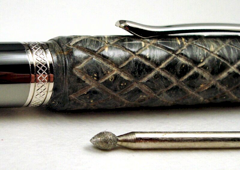

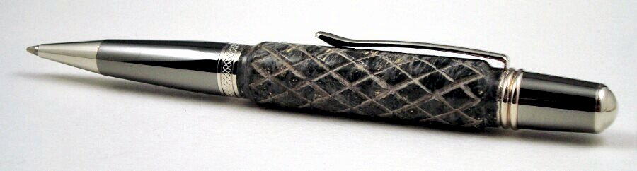

This is a piece of stabilized boxelder burl on a Sierra kit. The burl wood is probably a little too busy for the Pen Wiz effect. But using a stabilized wood works well.
Here's a close-up of the common diamond tipped burr I used:

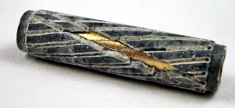

There is definitely a learning curve with this machine. This is what happens when the cut is too deep - chip out:

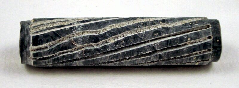

This is what happens when something gets loose mid-cut - unintended wavy line:
