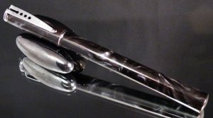

1+ for the PSI collet chuck . It comes with a set of 5 collets , tommy bars and a case for the the same price as the Beall chuck body alone. Watch Amazon for it to go on sale , I got mine for $75 with free shipping . You can use the collet chuck for many other uses including drilling on the lathe and even making complete pens . I made this pen using just the collet chuck , no mandrel .
