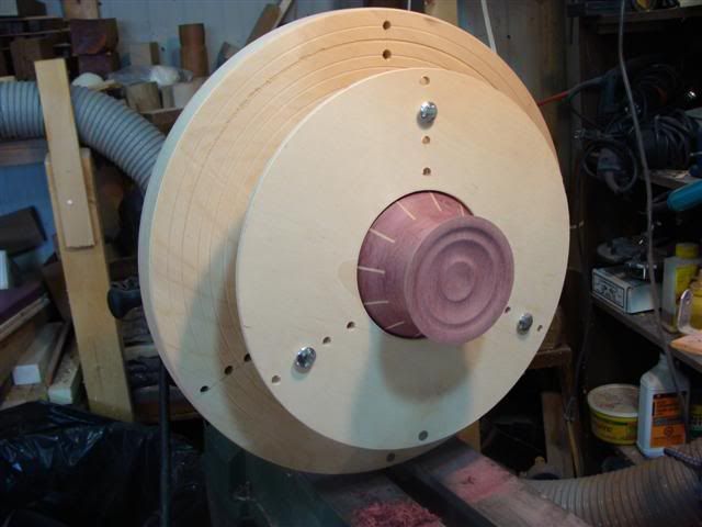

After making my 12 segment sled for cutting segments and a big 18" donut chuck for the lathe a couple days ago , both of which I showed in another discussion , I decided to try them both out .
Cut and glued up the pieces for this very basic segmented vessel yesterday and turned it this morning after the glue was cured. I found out that . . . Hey . . . this is fun. Will have to try to gradually get more advanced with it now.
Here is a shot of turning the foot in the donut chuck

Very impressive!!! Certainly doesn't look basic to me either. The precision of the joints looks perfect. Very well done.

Not sure but you might want to check with an experienced segmenter about the stability and strength of the checkered segments. They maybe should be staggered.

I checked with very experienced segmenters before ever starting . It is called a checkerboard pattern and was not intended to be staggered. It was from them that I got my information. Can't beat getting it straight from experienced segmenters. . For someone that doesn't know how that is done, the four boards were all glued together lengthwise and then the segments were cut out of that strip which is actually much stronger than a solid single grain board . Every other segment is flipped over and glued into a circle the same as any other piece of wood to give the effect shown .
