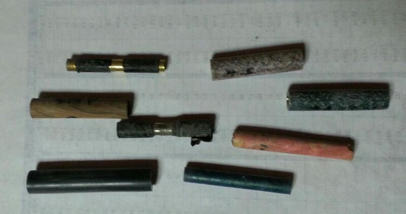

THe way I do it is to take an acrylic blank that I messed up on another pen (usually a 7mm pen) and turn the material down so it just fits inside the tube of the pen you are trying to make. Slide that onto the 7mm barrel trimmer shaft and you have a custom trimmer.
Or you can go the lazy way and wrap electrical tape around a tube, at the bottom and the top, until it fits snugly into the tube you want to trim.
