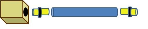

Here is what I mean by a press block. The idea is to transfer the pressure from the pen press to the collar without putting any pressure on the plastic threads.
Ok, we've agreed that the couplers are now metal. But I'm afraid I don't see the logic or merit in using a press block. I've heard it mentioned before too.

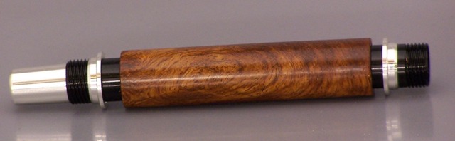

Below is a pic of a part assembled Baron. ( Yes the Rat does do wood now and then:eek: ) Both couplers are in place ready to be pressed in.
Now the dilema. I normally press both in together. I use a plastic coated clamp. If I only do one end at a time, then there is a risk of chipping the finish on the blank at the opposite end. But ok, lets say it doesn't.
Now I have to place the fitted end into the press block, right?
No thanks, the plating on the trim ring is the Stirling Silver and I don't want some chunk of hardwood rubbing on it.:cool:

It sounds like it works for you. And I agree that the outer threads are black coated metal, but I know from experience that they can be crushed. If there is too much pressure on one end, the collar can damage the threads on the other end, it happened to me with I was pressing both ends in at the same time. When I called BB to get another he sent me a free replacement and told me to learn to use a press block. I've never had a problem with the hardwood doing damage to the finish.
Are you putting the cap on before pressing it into the tube?
