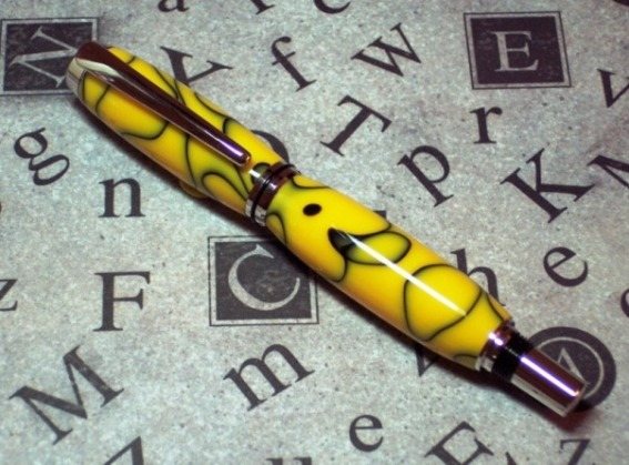

This is a Baron made with AA-28. I did not color the tubes and they do not show thru the Acrylic. In my opinion no color is necessary. But you might want to just to be on the safe side.
