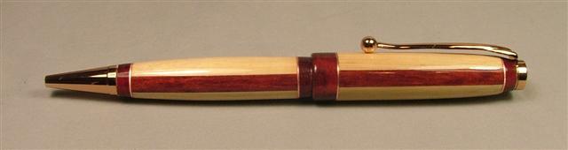

Both of these pens are made with bamboo. One with a blank from CSUSA and the other from flooring. If you wax your bushings make sure to seal the ends of the blanks or the wax WILL run into the end of the blank. ( I read that in a book somewhere:redface:) Bamboo also has a tendency to grab your tools and cause you to make deeper cuts than you planned to. It finishes well and one side will have lines the others may have a lot of dots. the more crazy the grain the better it looks.

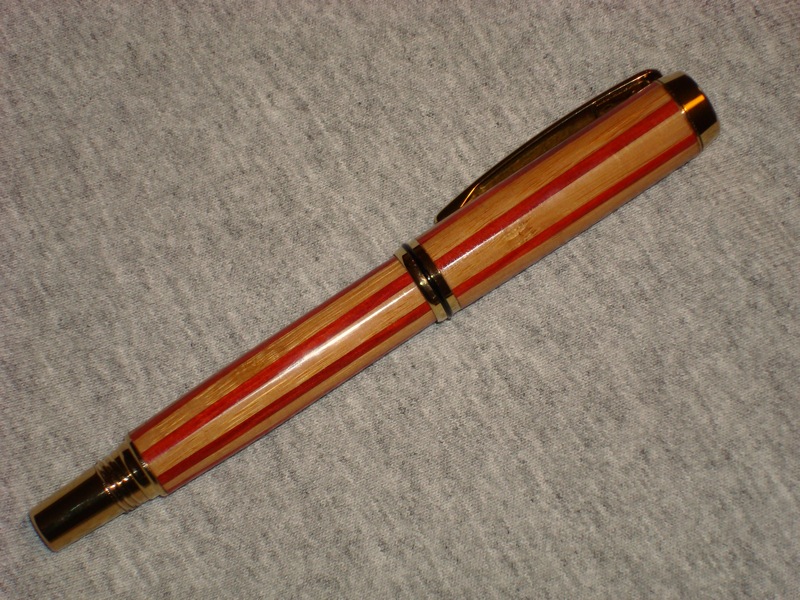

I've done 2 pens in Bamboo (can only find photos of 1 at the moment...) and it was, for me, no different to turn than most other woods. Maybe a tad bit toward the Wenge end, in that is a bit prone to splinter due to it's stringy nature. I also did one with just a wax finish ( sanded to 1200g, then the Hut PPP sticks) and it has a silky sort of texture to it that I really like, but I don't know how long it will hold up with daily use. The other was done with a CA finish, and it looks sharp. (My sister has this one, Pictured, and her boss keeps trying to steal it.) I'll agree that it is a bit bland, but not in a bad way Mine were the ones that CSUSA sells. I have a bunch of bamboo flooring that I keep meaning to glue up and try, and I also bought a striped bamboo cutting board that I need to cut up for blanks too, I just haven't gotten around to some of this...

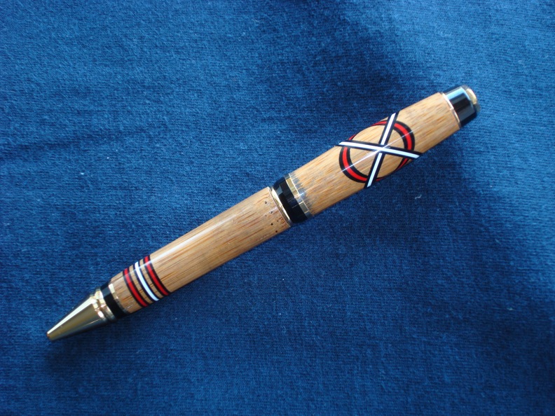

Pretty plain unless you dress it up. Another option and my take on it. I had a couple small canes that I used but not sure where you can get them from.

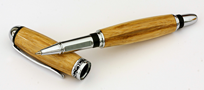

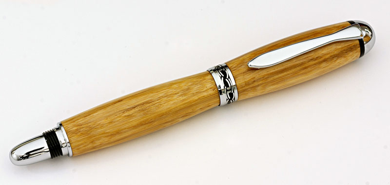

Bamboo on PF
This is "furniture" grade bamboo on a PF which as you are well aware comes both as a pen & pencil style. The "pock" marks give it some distinction which is not very evident on many bamboo species.
