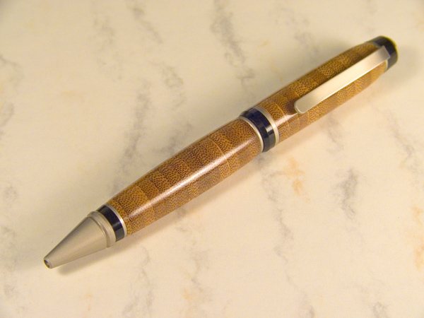

I have turned a couple of bamboo pens using blanks cut from a cutting board from Wally World... Here's a cigar that turned out pretty well...and sold the first time I showed it to some potential customers:

Originally posted by DFM
<br />I have a bamboo pen im my gallery, if you would like to view it.
Wow! What an interesting effect. That was obviously not a premade cutting board. Did you make the blank by gluing up individual pieces, or how?
Really neat!
DFM
Sep 26, 2005
177
TX, USA.
Thanks DocRon, yes the pen consists of a whole bunch of small diameter bamboo - cut stacked and glued to form the blank.
