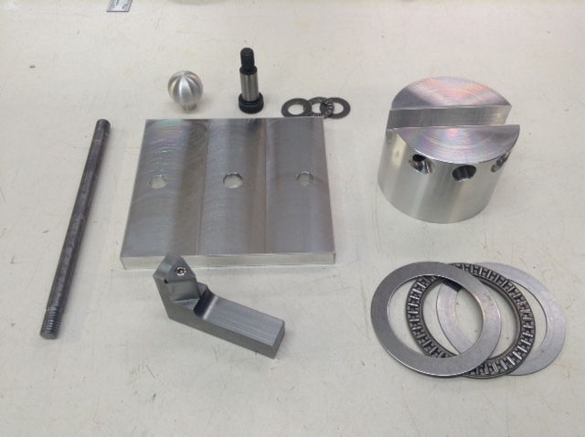

I contacted Mike Roux and asked if he could help make it if I bought the materials. Since we both have the same model lathe it is easier to make 2 than one. We used 1/2 aluminum plate for the base and 3 inch diameter aluminum round bar stock for the tool post. I bought thrust bearings and races for the bottom of the post and for the shoulder bolt rather than just a friction fit between parts. I bought most of the parts off Ebay or Amazon depending on who had what cheapest.
First picture of the parts used in making it.
attachment.php
The handle is 3/8 round steel stock from Home Depot. The ball is the first one Mike made to fit his on his lathe.

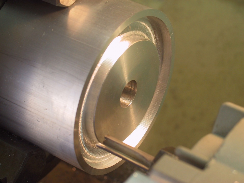

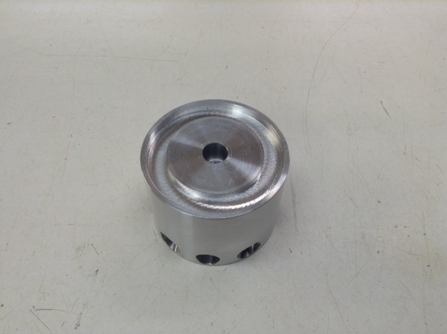

He milled the plates flat and drilled the hole for the cross slide hold down bolts and the center bolt for the tool post. He used a trim router with a carbide bit taking small cuts to cut the slot the thrust bearings fit into in the bottom of the post. It has been drilled and tapped to take a 1/2 shoulder bolt with 3/8-16 threads.
attachment.php
attachment.php

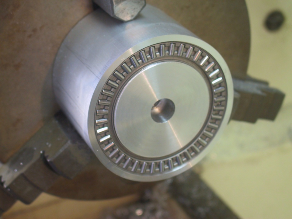

The bottom race sits about .015 proud so it rides on the bearings instead of the tool post. He nest drilled, milled and tapped the holes for the set screws that hold the cutter arm in place. Then cut a 5/8 slot for the cutter arm.

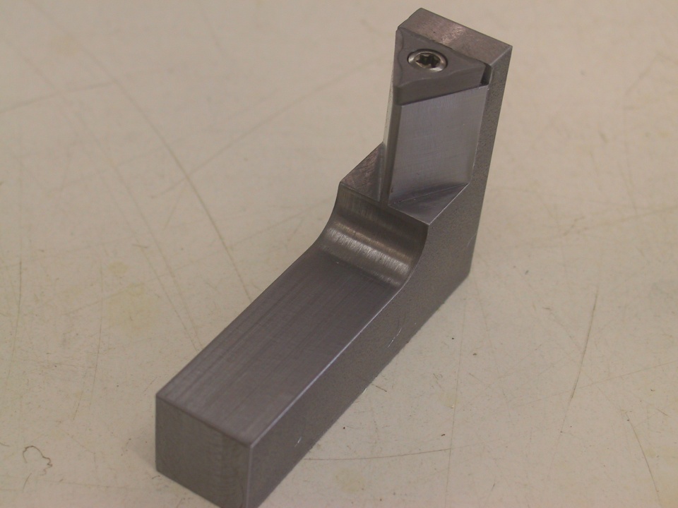

We made the cutter arm out of 5/8 steel flat stock. Mike cut the pieces from a 5/8 x2 x12 cold rolled steel piece of stock and then milled it to the shape you see. We borrowed an insert screw from one of my other tool holders until the ones I bought get here. I bought some German Manufactured ones instead of CHinese and it will take a couple weeks for them tto get here, Its a standard 4mm insert screw.

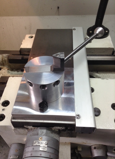

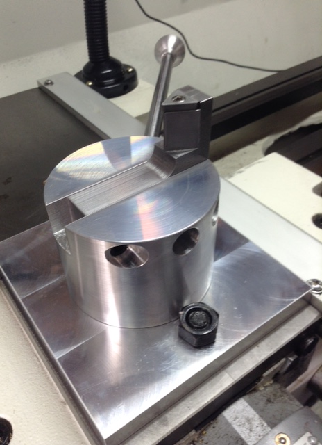

THere is a small thrust washer that goes between the bolt head and the aluminum plate and both thrust washers have steel races to keep the bearing from making grooves or dimples in the aluminum as its being used. Assembly is easy and we bolted it on to the lathe and Mike cut the ball for his.
attachment.php
attachment.php
Now nothing goes according to plan and this was no exception. My lathe is newer than Mikes and they have made some changes. Like the DRO scales. Mine are different than Mike Roux's. Mine limit my cross slide travel half an inch shorter than Mike's. My ball turner would not make to the center of the axis for the lathe with the cutter. We had to change the bolt holes from front to back to left to right and move the bolt hole for the center of the tool post froward 3/8 of an inch in order for mine to be able to get to the center of the part when I cut it. We got the bottomplate remade and mine is now functional.

I will grab some pictures when I next use it. No you form the ball all at once. It does leave a shoulder next to the threaded rod. You can get to the center of the ball at the very end but not where its mounted. You cut from the side not the end. Once you go past center the material is coming up past the cutter from below and rubs not cuts. You can cut round or eliptical spheres depending on what arc you make the cutter swing.

It appears from the pics that you gained stability by increasing the toolpost height and reducing the cutter holder height. But to me, it looks like you now have more cutter adjustment than you could fit stock above the toolpost. ?
I love the thrust washer arrangement....that is cool.

The diameter this set up will turn on our lathes is up to 2 inches /50 mm. Even At that diameter it will still have some clearance left between the ball and tool post. I dont forsee the need to turn anything bigger. Most of my stuff wont even come close.

Just a little unclear as to the proper orientation of the tool .... in the second last picture the point of the carbide cutter seems to be pointing towards the headstock of the lathe .... I thought it should point towards the axis of the lathe (which runs between the headstock center and the tailstock center).
Can you clarify that please. Thanks

It pivots 360 degrees with nothing in the way. When you chuck something up in the lathe it cuts from side to side and around to the center of the axis to form the ball.
