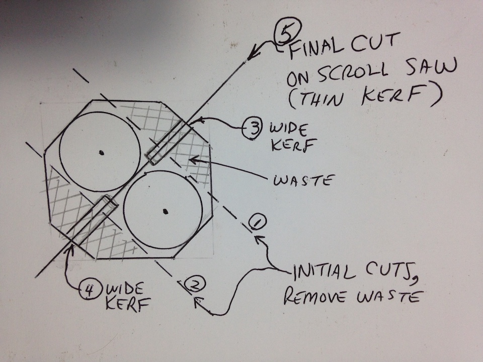

What style pens do you get out of a piece after it's ripped in half?

I have an assortment of bakelite pieces and rods, most of which are about the size of the one in this thread. I can usually get up to the "Jr" series type of kit. It takes very careful, and precise cutting, and even more careful drilling. I do the "rip" cut with a scroll saw which is the thinnest kerf available to me.
Do you split it into two rectangular shapes or on the diagonal?
If ripping diagonal, that gives almost an additional 1/16" across the center of the cut pieces.

Rip Bakelite
These are the typical series of cuts to divide a single octagon bakelite piece to yield two blanks. If you try this, it has a good chance to fail, because it is pushing the limits. You should use push devices/jigs to keep fingers away from blades for safety. Proceed at your own risk! :eek:
I cut away portions of the blank so the final thin kerf cut on the scroll saw can be done easily, and with precision. Cuts 1 and 2 remove waste. Cuts 3 and 4 (table saw) are wide kerf cuts to minimize remaining thickness to be cut on the scroll saw. The final cut (5) is the thin kerf scroll saw cut. After these cuts are done, I locate the turning center, and mount the blank between centers to ruff-turn to a cylindrical shape. Remove as little stock as possible. Mount in collet chuck for drilling. This supports the material for drilling what will be a fairly thin-wall drilling process. I drill a pilot hole (sharp, moderate speed, lubricant and cooling), then step up drill bit size as needed. Note: the actual octagon shape bakelite usually has four smaller flats and four larger. The idea is to perform the prep cuts so the resultant two blanks are "touching" the small flats, as that will yield the largest diameter blanks.
Sometimes, after all these steps, and with the high possibility of blank failure, I wonder if it is worth it. But I do it anyhow. Some would say I am hopeless! :tongue:

Thanks for the explanation and diagram.
