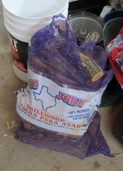

In parts of Texas Mesquite is plentiful. As a result, it is packed in 25 pound bags and sold to use in smokers. Most are small branches less that 9" in diameter and about 18" long. It is dry, very dry so it will burn hot.
Is it possible to use this wood for making pens? If so, would you suggest stabilizing it before turning?
Thanks if advance.

$11.99 and I got four blanks from two pieces.

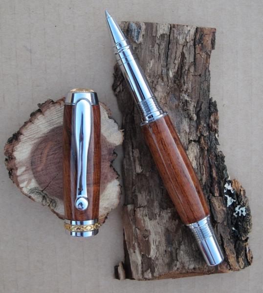

Well here is the first pen from the sack full of Mesquite.
I think I am better off using the rest of the wood to smoke with and take Seamus up on his offer.

Your pen looks great. Mesquite tends to be one of the more stable woods with regards to movement, so it is generally not necessary to stabilize it.
