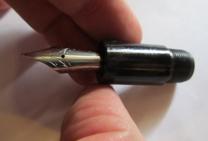

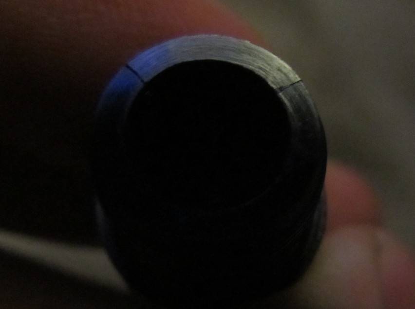

Well, I turned two sections, and the same thing on both. Several cracks on the threaded bit of this plastic:
Bear Tooth Woods - Invisavue UA-01 Black Pen Blank
Is this stuff just not good for threading?

I think your turning the inside threads firtst, correct? Then screwing in something to 'support' the blank while turning the outside threads?
Maybe the 'support' is too large and once the material is removed on the outside, it's just enough to allow it to crack....
This is just a guess....cuase I really haven't seen your set-up.

It's really frustrating b/c I'm doing the same things with this as I do with the smaller sections and I haven't had any cracks like this. I've squished a bunch of super glue in the cracks and will chase the threads to see how it does. Ugh...

Another way of saying what Scott said - is that it is better to thread the outside first, put some kind of a support cap on it, and then thread the inside.
Different PR has different characteristics so the technique and sequence of threading become VERY important.
I have not done this, only reading the different posts on this as I intend to start doing the kit-less in the near future. (I hope I got it correct.) There was another thread on this very subject just a few days ago.

IT's not PR though - it's acrylic. I'll go ahead and do the support collar though - for the next section (making three of these).
Thanks

I've net tried threading this material, but I do know that as even though it seems relatively soft, it dulls my skew pretty fast, so it might be harder on taps and dies too. Might not be the best material for sections, and I'd be even more leery of using the triple starts on it for bodies for that reason.

I tried this marterial too and it is not near as friendly as the regular acrylics. My results were similar to yours. I used up the 2 blanks I bought and never tried it again.
It is more opaque than normal acylic. To do this, I think they have to add more pigment, which affects the workability of the material. I've also struggled with black acrylic, which is more opaque than the normal arcylics. My conclusion is that more pigment means less workability
