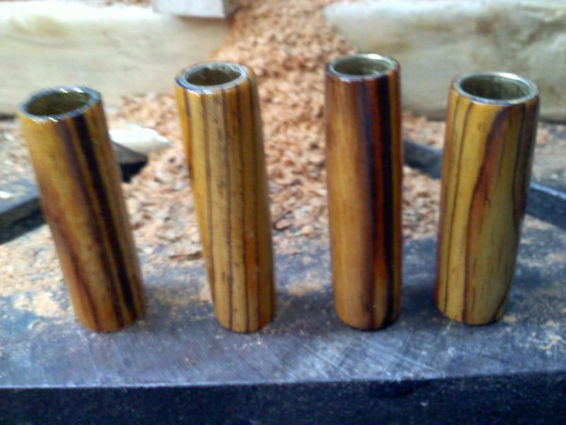

Sorry about that. Internet has been down here since last night I am trying to do this on my phone and the battery was going dead. Anyways here is a pic

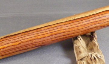

I forgot to mention The back side of the blanks have not to bad of color to them
Could be one of two things.
1) you drilled the blank off center and the dark side was the portion that was closer to the outside of the blank.
2) If you take a fresh cut blank and lay it somewhere, the surfaces will all darken with time. BUT the surfaces that get more air and light will darken further into the blank than the surface that its laying on that receives little of either.
I'm attaching a pic of a piece of Cocobolo with sapwood near the top. This pic was taken when fairly fresh turned, so its pretty light too. The sapwood will stay pale, same as with African Blackwood which is in the same family.

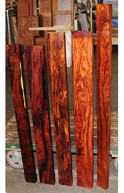

I believe this is cocobolo. I've had pieces of mexican cocobolo that were very dark red & black in places and very light yellow in others. panama cocobolo is even lighter.
I forgot to mention that the pictures I posted are Mexican Cocobolo. As others have mentioned, it will certainly darken over a short period of time.
Please re-post your pens in a few months so we can see the difference.

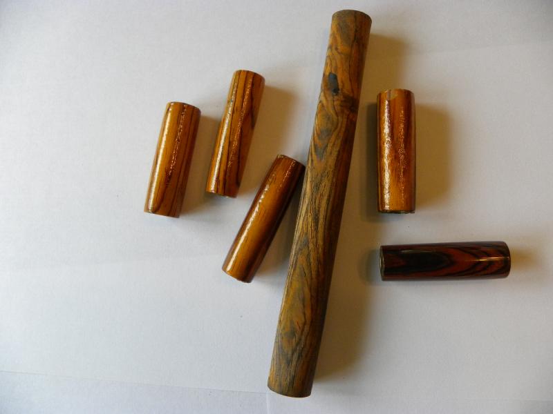

RDH79
Mar 25, 2008
1,549
Rimersburg, Pa, USA.
Grip or not.
Thanks Guys for the replys. Here is the last post. Here is a pic of the blanks and one turned round plus one that I wanted them to look like had it from another batch of cocobolo. The orangish one have cocobolo grain and turn but are not the dark like have turned many times before.
Do I have a grip to where i got them??
Thanks
