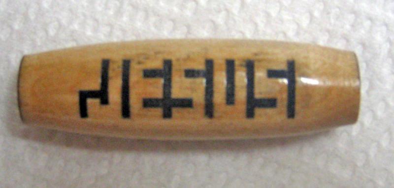

Yes, I was putting normal coats of CA on then wiping the black acrylic on..
Heres another image logo I tried as a test..
Sorry about the crappy picture quality as I did it just with the flash..
You can see bits of the black around the lettering.. I will try a shot of spray with another test one tomorrow.

It appears as though you have sanded away the CA in certain areas. If the CA finish completely encapsulates the blank, then the paint will not penetrate into the wood and all excess paint can easily be wiped from the surface.
