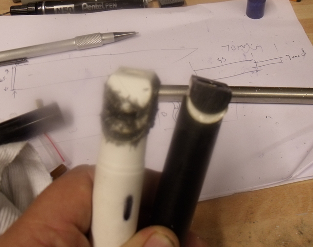

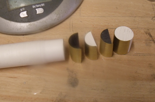

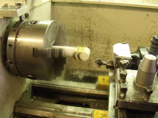

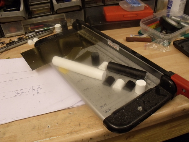

Here are the WIP pics. Again, apologies for the smudge.:redface:
Max, I use CA for EVERYTHING. :biggrin: I know lots of folks have problems when drilling through metal and it heating up and wrecking the joint, but now that we know the problem, it's simple to overcome. I drilled this with a 4mm pilot first then used about 7 different sizes to get to the final size.
All of the drill bits were freshly sharpened and I used soapy water as well.
I drill on the lathe at around 600rpm. I would go faster but never slower than that.
The only 'trick' with this design is that the segments including the shim must have the exact same diameter as the cutter. :wink:

Eric, the lathe was used to hold the router only. :wink: ( and drill the holes of course.
Granted, a metal lathe helps but a half decent MDF jig and a router table would do the same. :biggrin:
