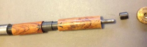

I am working on my first Perfect Fit. It uses the slightly larger B mandrel and the bushings therefore have the larger I.D.
I have glued the upper tube in flush with the cap end creating the space for the centerband and avoiding having to part it off. PF1.jpg

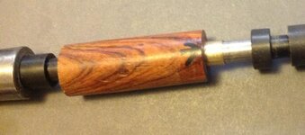

My problem is the blanks do not both fit on the mandrel with the bushings ... the last bushing would be over the threads which are the standard mandrel size... PF2.jpg
I have resisted turning them between centers for fear of flaring the unsupported tube at the CB. I probably will just turn the cap blank using the mandrel and the lower between centers but I would like to hear what others do.

That has been a problem for years!! I resolved it by putting spacers on the mandrel and turning one half at a time.
TODAY, I would resolve it by using a "mandrel saver" tailstock piece (and turning one half at a time). Unfortunately, you would probably have to make this a "dedicated mandrel saver, since I think you would have to drill the hole a little larger to accommodate the "B" mandrel. If you are making five or more pens, the $20 investment is not too bad (IMO).

Simple fix, Lenny! Since you are using a Beall collet, shorten your B mandrel until the "b" nib bushing extends over the threads 2 or 3 turns. Most of this bushing should still be on the mandrel. Use the washer and 7/16 nut that came with the mandrel.
Using this method (and it's the best I've found), the cap end of PF must alway be loaded toward the headstock and the nib toward the tailstock.
Since you are using my "1 7/8 exposed" method, it is CRITICAL that you use the "5th" bushing in the set over the exposed tube. Besides acting as a "CB measurement" device, IT KEEPS YOU FROM DEFORMING THE EXPOSED BRASS TUBE.
Since PF is one of the few that uses a b mandrel (Woodcraft's A bushings of Cambridge and El Grande work better for me), a different collet than a 7 mm mandrel, you can scratch a mark on the B mandrel, slide the collet to the mark, and store bushings in order between the collet and the 7/16 B mandrel nut.
I've tried a mandrel saver with PF, I had terrible results. It was difficult for me to accurately drill out the 7mm mandrel saver. AND, FWIW, that 7/16 nut comes with that particular mandrel for a reason . IMHO,The bass nut just does work very well for this set up.
I hope this helps.

Andy, if I follow you correctly your saying take the B mandrel out of it's Morse taper and use it with the Collet chuck? By doing so I will gain a little ... allowing the nib bushing to be over the mandrel more?
I did figure out that keeping the sizing collar on the exposed brass was the only way to go!
Joe and Chris ... Thanks, my first thought is always to TBC ...just seems difficult to do the lower blank that way in this case.
Mack, you ARE lucky to have those bushings! :cool::)
PenMan1
Jul 8, 2009
6,380
Eatonton, Georgia
That's exactly what I'm saying, Lenny. The other option (since I can't find the standard 8mm Mandrel rod, stand alone) is to buy an 8mm (I think it is, but measure) piece of drill rod and THREAD THE #%^+ rod to the closest size you can get to the actual mandrel rod size.
Making your own mandrel rod allows you to not have to "patch" a set up that was factory made to use a "universal" nut that doesn't work with this particular set. As you are finding, I found the "b" mandrel with the taper to be perfectly useless for PF!
Try your Beall (7-8 collet, I THINK). I think it will end all of the jury rigging. BUT, notice that the little washer that came with the mandrel fits snugly on the threads AND is the exact size of the nib bushing. COINCIDENCE? I don't think so:)

Turning the bottom barrel of PF TBC IS difficult, but can be done.
Since the bottom bushings use no collar (jams up like slim bushings), the only way I know to TBC is with 60 dead and live centers. To get the blank tight enough to turn flairs the thread connector and the nib fitting, requiring them to be epoxied into place. DAMHIKT!

The problem I had with the B mandrel IN the taper is that the mandrel is so large that it wouldn't go into the taper far enough to get the threads where I needed. After experimenting with using another PF nib bushing between the taper and the clip bushing, I finally just took the rod out of the MT and stuck it in the Beall. I've been a happy camper ever since.
Lenny
Jan 6, 2009
3,475
Searsport, Maine
I NEVER lose anything but unfortunatly my washer and nut is on the long term "misplaced" list! :wink:
I will try that.
