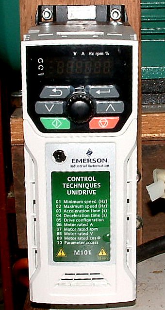

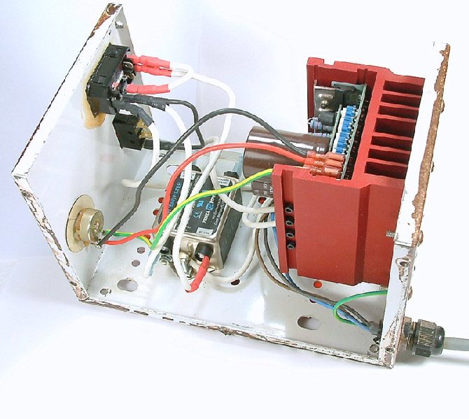

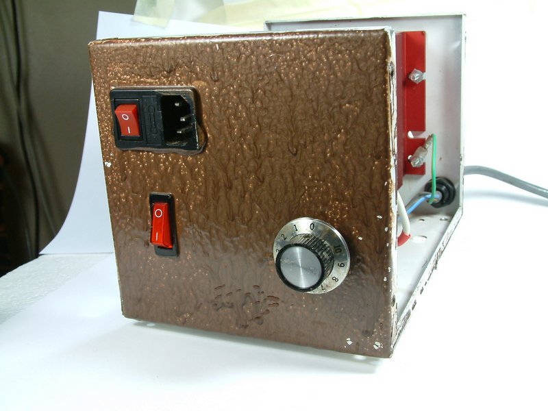

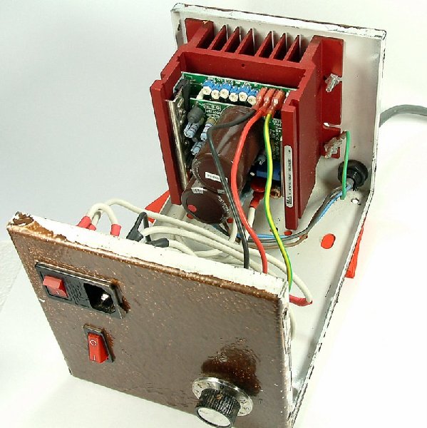

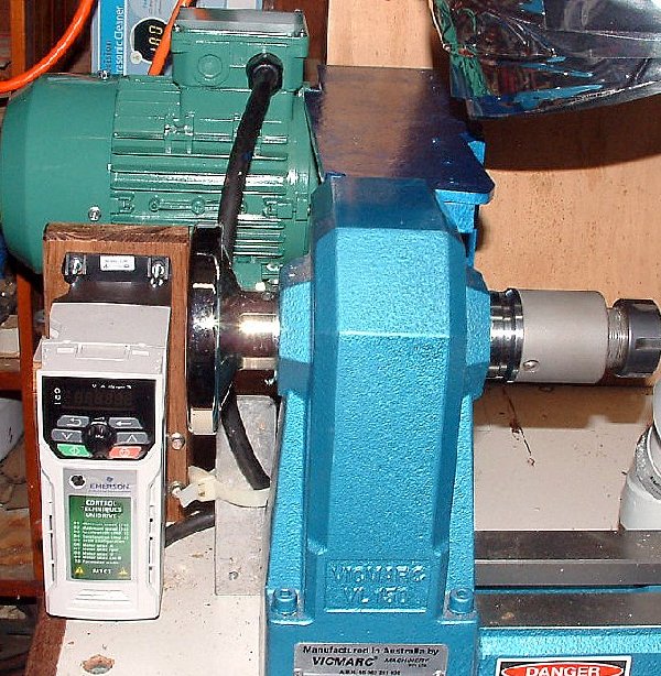

Some pics of two of my variable speed controllers the oldest one on the VL100 and the newest on my VL150 I bought separately got info from the same supplier to wire up been fantastic. What they do for me is create two extra phases plus the one incoming to make three phases. The one on the VL100 uses a three phase star connected motor the VL150 a Delta connected three phase motor.
Peter.
