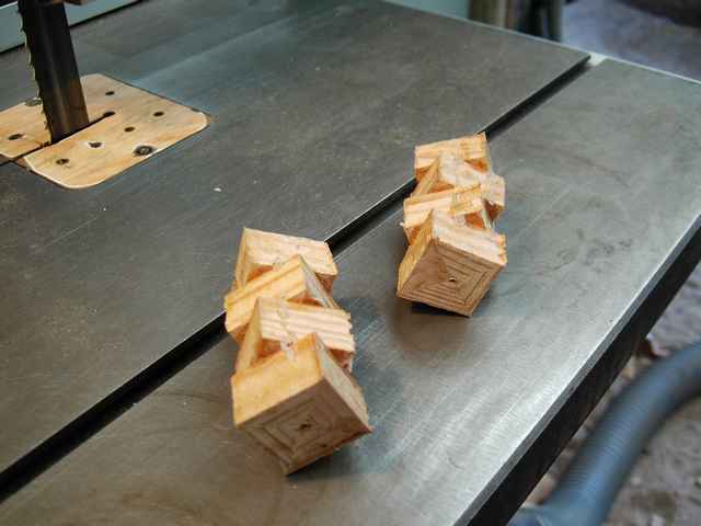

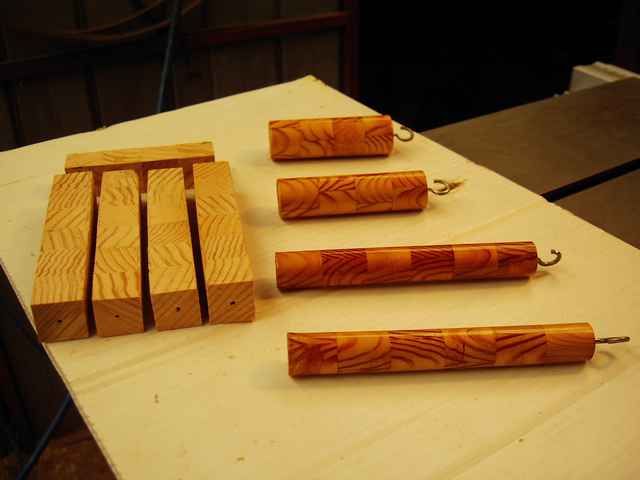

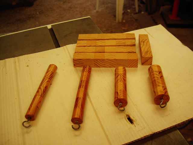

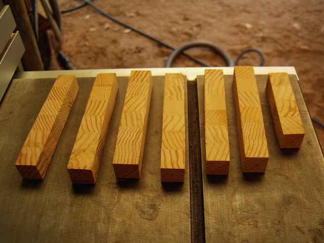

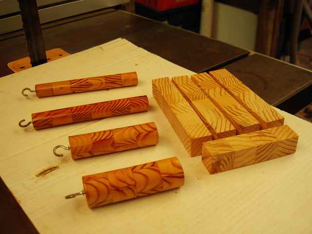

Hi everyone,
When I was cutting the length on the diagonal pen blanks from the red Cedar, I got dozens of little triangle pieces that I decided to glue together using PVA.
I've glued these little off-cut pieces in 2 different ways but in similar pattern, one style would only give enough finished diameter for a pen but the other style did nearly gave me double the round diameter, which would be suitable for bottle stoppers and other things that use about 1" or so round!
After the glues were dry, I gave them a square shape on my round disc sander, proceeding to turn a few samples round and treat them the same way as I do the other timber samples. They did come up quite OK considering that the off- cuts come out of the bandsaw.
This type blanks can be easily done with all the blanks left overs (small pieces) that most turners get from their pen making. In this case I used only Cedar, but a mix of any wood blanks that were made into pens, would do. Cutting the blanks off-cuts in triangle shape and put them aside as you go, would one day give you enough pieces to play around and put together pen blanks that can quite easily end-up a lot more interesting then you could have anticipated...!:wink: Anyway, its just a thought!:biggrin:
