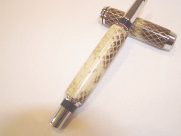

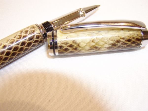

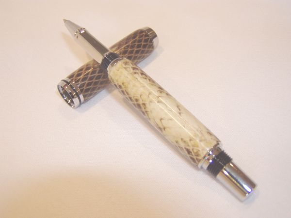

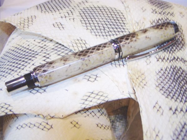

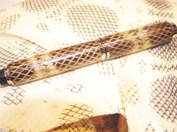

Well got this for a while and did put in practice before Christmas, several e-mail with Don ( it's virgil ) about pressurised PR, here's the result, Pressurised PR darken the skin as Sea Snake skin are thicker than rattler snake skin and they use chermical to tanned.
Comments are welcome

That's pretty darn slick! Or should I say slimy? So, It's an actual sea snake skin? Did you catch it?

We went to the Long Beach aquarium last night and saw a few of these. They look much better wrapped around a pen tube encased in epoxy. Very nice.[:D]

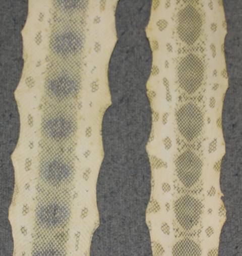

Ron I brough the skin ( 2 skins actually, different patten)they are 1.85 metre each or 6' long they are a little thick than the rattle snake like a thin cardboard paper, some people got the snake when fishing but prefert to cut the line rather take the ook out of the snake mouth, they give a nasty bite, the skins I got have no scales

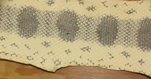

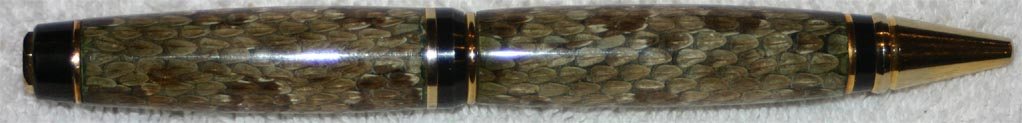

<b>Terry:</b> If done with TLC the seams are invisible. I glue the skins with CA. Do not make a butt seam, but overlap just a bit. Here is a picture of a rattlesnake pen on the back side where the seam is hiding.
<br />
<b>Scott:</b> I've been doing some research and Serge and I have been casting our PR in pressure pots. Have you seen the last snake skins I posted? Serge's sea snake was cast under pressure also.
<b>Serge:</b>My apologies for hijacking the thread, but I already had a picture of the seam side of a snake skin pen. The seam question get asks lots...right mate!

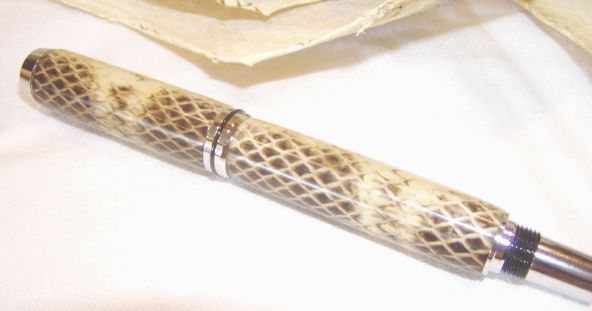

Terry I glue the skin with CA for the seam you can see it, as Don say the rattle snake are even and got consistency of scales so you will not see the seam, for mine you will see it because of the lack of scales here's the photos, for your info and other person the thickness of the rattle snake I brough fron Don lately is 0,0115" and the sea snake is 0.16" ( if I trust my digital calliper ) one thing as well the rattler snake skin is much soft and malleable than the sea snake skin who is like thin cardboard
