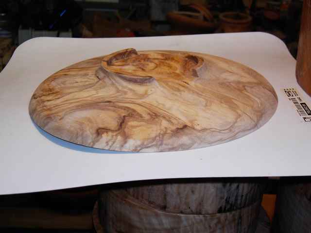

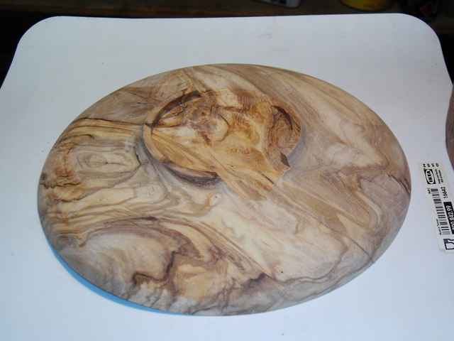

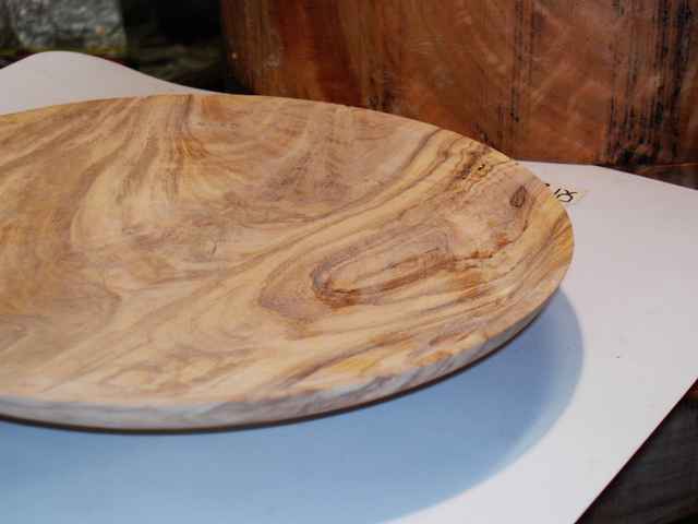

The rough turning shape/design was telling me that I intended to make a thin wall piece on it so, there I went...! after removing most of the timber I wanted, and making a few stops for the compulsory, epoxy and sawdust mix patch ups, I was making the final pass with the gouge on the inside, (very fine cut) before starting the sanding process, when all of a certain, the platter took off like a frisbee, missing me and most things, right to the outside, if I didn't know I would thing that someone had a remote control operation/maneuvering that thing...!
Well, I could see that the platter could fly, as it had so thin wall (about 5mm) and very light as the timber was also very dry, the problem was why did it took off? and how much damage was on it?
It landed like a frisbee also so as I got closer I could see that most of the foot/base was gone, and not a lot more damage I could see, as the platter did do a straight flight through the room opening (no door) up to the soft ground about 10 meters away.

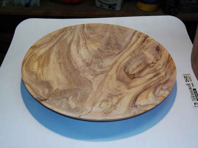

That was the end of that piece for me, as I needed to finish whatever I had to do today, and that one need some major surgery. So, I got the other one (12" diameter) and the last out of the dry stuff, that I knew I could finish today but by then a couple of hours were gone and I had to start all over again...damn!

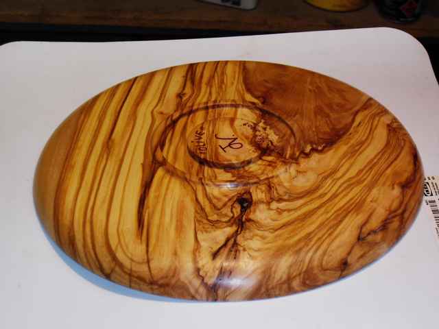

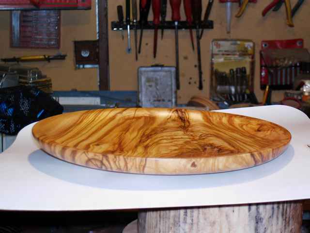

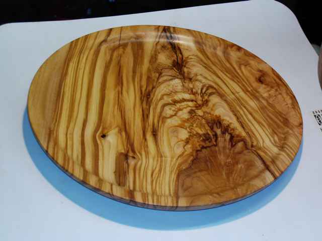

I did, and this time I didn't wanted to risky going too thin (extra vibrations), so I got the bigger holes bogged a little patch here another there and I was on the sanding stages in no time. Went as far as 400 grit as per normal, and gave it 1 x coat of Arganoil natural timber oil, let if keep turning for 10 minutes or so and give it a light buff with a piece of flannelet rag.

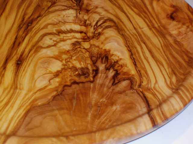

I wanted this piece to look as natural as possible, without any major flaws but not finished to a gloss and flawless surface, so small cracks and other small flaws are visible but not, spoiling the natural look of the piece. One only has to look to the grain, figure and colours to realize that this piece has come from a very "busy" part of the tree, certainly not from a straight log...!

In relation the frisbee flyer, one day when I feel is time to salvage the piece, I will make another base/foot and give it a finish, that I'm not sure what yet!

This is indeed what makes good quality (aged) Olive Wood be what it is, just a magnificent and unique natural product!
For those that never turned Olive wood, turning something like this is certainly a rarity due size of the blank (diameter of log) necessary to produce a clean 12" diameter anything, but there is also the smell that produces when is getting worked on and beyond (smell stays in the shop for days).
Is also a shame that Olive wood is so heavy, (even when dry) for postage purposes, and that is not much I can do about it, but if you have never tried turning Olive, try get some (I've got a good stock of it) and experience what I've just mention. It doesn't need to be a big piece, a simple pen blank has enough timber to give you a good idea of its natural aroma but if you really want to experience something quite unique and very pleasurable, get a blank as big as you can afford, preferentially not too dry (the greener the stronger the aroma) and turn it, into anything you want, and I'm pretty sure you will enjoy every step of it...!
Remember, Olive wood is like Port (the wine), the oldest (matured) the better, clean, natural flaw free olive is possible but Olive wood without flaws (character/colour/grain/texture), is like..., is like..., is like a pen without a cartridge
