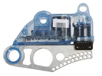

Mark - curious - why a new blade as well? Does the stop activation destroy the blade?
When the SawStop brake activates, it plunges an aluminum block into the spinning blade. The blade cuts into the aluminum and is stopped quickly.
The action of the brake puts a lot of force on the blade's carbide tips. A few carbide tips may break off entirely. I have seen it from demos. The brake may also crack or flex the welds of other carbide tips that remain attached to the blade. The welds may have been weakened in a way that is not obvious from a visual inspection.
-> The danger is that a carbide tip may suddenly break loose from the blade while in use.
Speaking for myself, I do not like the thought of a razor sharp carbide tip heading straight for my nose at 120 mph. Others may not object to it as much, so they reuse their blades. :-o
