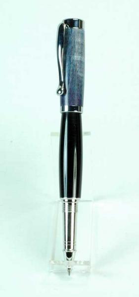

Andy, it will work. The Atrax uses Jr Gent II bushings so no problem with fit there. I just posted an Atrax cap on a Jr Gent II and no problem there.
