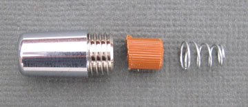

You guys are over engineering this. All I do is take the plastic tip off the rollerball refill, cut it to fit the postable finial. Once you got the length right, you can glue it in or not.
Problem solved.
Unlike this one, you should square it up.
