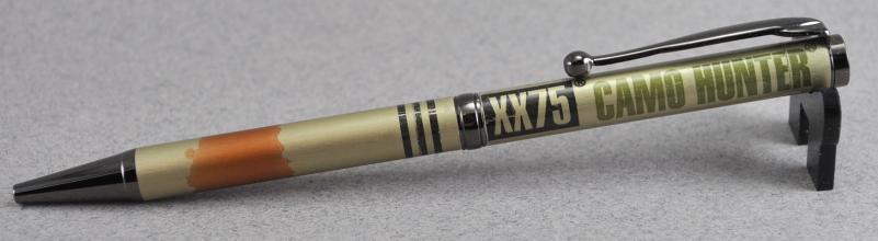

Arrow shaft pen #2

This one is built on a gun metal slim kit. The shaft diameter is a bit bigger that the first one did.
Both go the bow supply shop tomorrow as demo pens.
Hope they like them. :rolleyes:

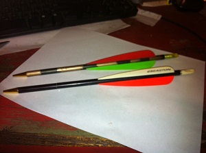

Very Cool, When my friend asked me to make him one he asked if I could include the knock, so I have to figure that one out yet.

I have made some one piece slimlines, and I take a file and file the notches on the transmission down a little and it makes it easier to pull out to change the refill. Just be careful and dont file too much.

Hmmmm, I have like 10 dozen carbon fiber shafts....can't possibly use all of them......
What spine shaft did you use here? 2175
Scott (been awhile since archery days) B

The first one it did was on a 2117 shaft and the second is on a 2175 shaft. I shim in the 7mm tubes. I was at the archery shop yesterday, and they gave me a few pieces of shafts with different diameters they use as shims.
