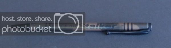

Does anybody actually put out an arrow pen kit?
