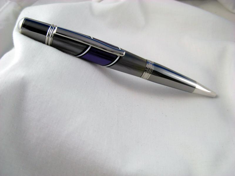

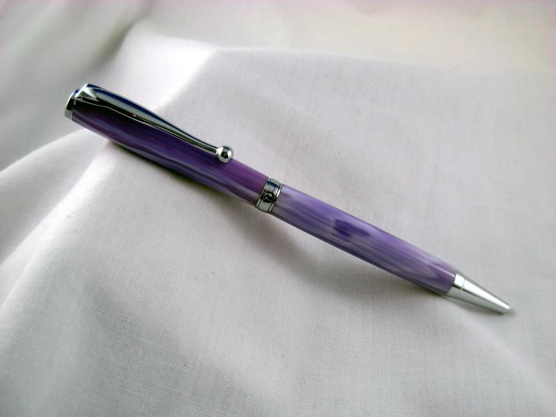

I've attached a couple pics where I've used "purple". First is spring lavendar I believe and the second has a stripe of metallic purple.
Jeff

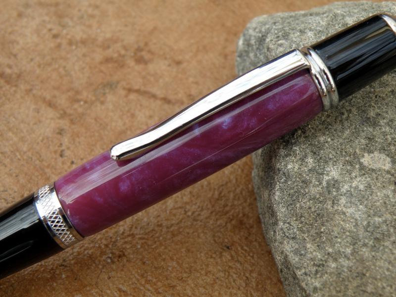

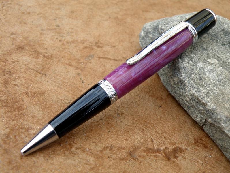

If I were going purple, it would be the purple quatz from Dawn and Ed. The deep color and flecks of pink are great.
