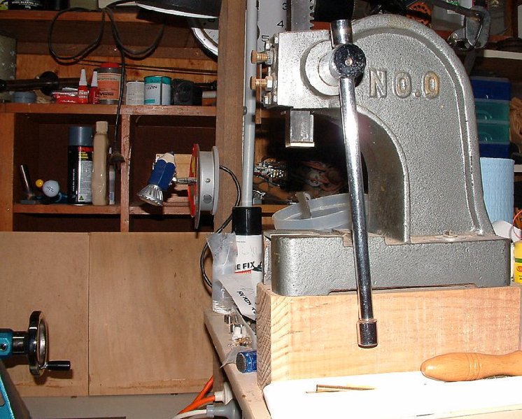

For pressing pens I made a small table to place at eye height a 1 Ton Arbour press. The small table is mounted on a water pipe stem bolted to the floor adjacent to the lathe where I sit at a Draughtsmans swivel chair to turn. The idea of running around elsewhere to press or removing and setting up the lathe etc not on I just swivel and press its ready 24/7.
Any longer press I do using a Stylis Press fantastic for the purpose. I can operate several tools from where I choose to sit.
I modified the one ton press quite a bit to satisfy me for accuracy. Your price in the states is dirt cheap compared with here.
Peter.

PenPal - I don't think your arbor press is going anywhere anchored down to that section of what is that like 5x5! LOL
