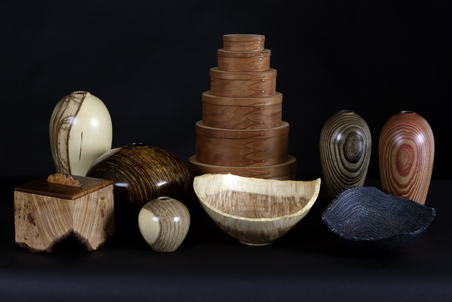

Catalpa can exhibit some really nice chatoyancy. The light can bounce around as you rotate the wood. I have some curly catalpa that just knocks your socks off. My favorite method for adding color in my bowls and vessels is to paint the piece with acrylic paint, then fully sand it again. The paint stays in the pores. See the red and black piece on the right side of the postcard.

I turned a small 1" sq. angle cut piece just to see what it would look like and it shimmers in the light.I turned a small bowl(very quickly) and it seemed that it would turn better dry then wet due to the softness of the wood?What do you think of that?I love the painted/snaded piece I will try that soon.Thanks for the pic,Victor
