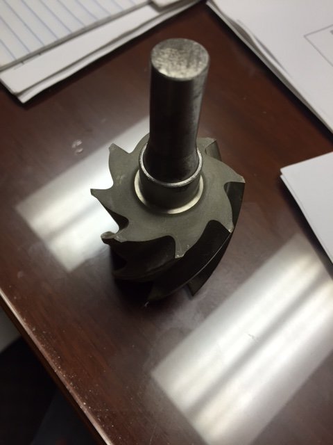

Anyone have info on this huge router bit?
1/2" shank
2" cutter height
2" diameter
Closest I've found is this but not the same.
https://wnwoodworkingschool.com/shop/big-daddy-pattern-bit/
Thanks for any help!

Thanks Ken, I should have clarified. It came with a router table lot I bought at auction through my father in law. I haven't received the remainder of the bits or table yet. I had figured router table only but thought a shaper would be possible but with the 1/2" shank size threw me off.
Are you saying for milling wood or for a milling machine? I assume milling wood, looks to me like it would be made for serious hogging.

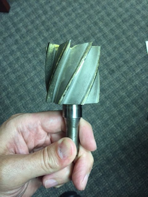

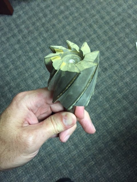

It is a cutter for a milling machine most likely for steel cutting at slow speeds, as in the few hundred rpm ranges with coolant. It looks like the shank has been ground down from a larger diameter, perhaps 3/4". The original shank probably had a notch or flat ground into it for a set screw to keep the bit from rotating in the tool holder. While you could get away with using it in a BIG router with the speed dialed right down, in a table with a fence, taking shallow cuts, I wouldn't advise it unless you are very experienced and understand what can go wrong. Lots. From what I see in the pictures looking at it with my phone, the cutting edges are dull and possibly chipped. New it would be razor sharp.

When you look into the toothy end, can you see any fastener head that might be holding the cutter onto the arbor? (Or does the arbor unscrew from the cutter head?)
From the things I've been reading, it most closely resembles a shell end mill cutter. Link to American Machine Tools "how to" page with line drawings of different tools ... LINK

Thanks for the link, I think you nailed it. No fastener etc, I'm think it's shaft was milled down as suggested above or perhaps it was a morse taper style at one point. I've bookmarked that link for down the road too.
I have a friend that owns a machine shop in s Georgia I see once a year or so and he said he may have an occasional use for it. Passing it along to him as I know he'll know what to do with it and don't have to concern myself with someone buying it off eBay and having a disaster from it.
