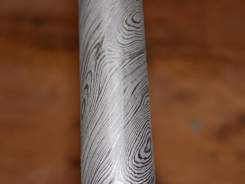

I have a friend who makes Damascus steel knives. He just recently made me 30+ round bars of Damascus steel.
These are all 12" long....they are about 1 3/16" in diameter In the raw form ..once they are turned down they should clear 7/8" all the way.
Most of it is wire twisted Damascus, some are twisted tighter then others, and some are just straight Damascus.
Anyone Interested in some?? I know that there has been a lot of people on here offering this recently...
I will be making a few kitless pens with this stuff...I also may pre-turn some barrels if anyone is interested....
the first three pictures down below show more of a straighter pattern, which still needs to be etched...

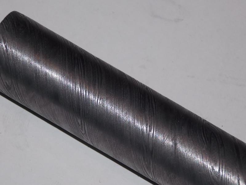

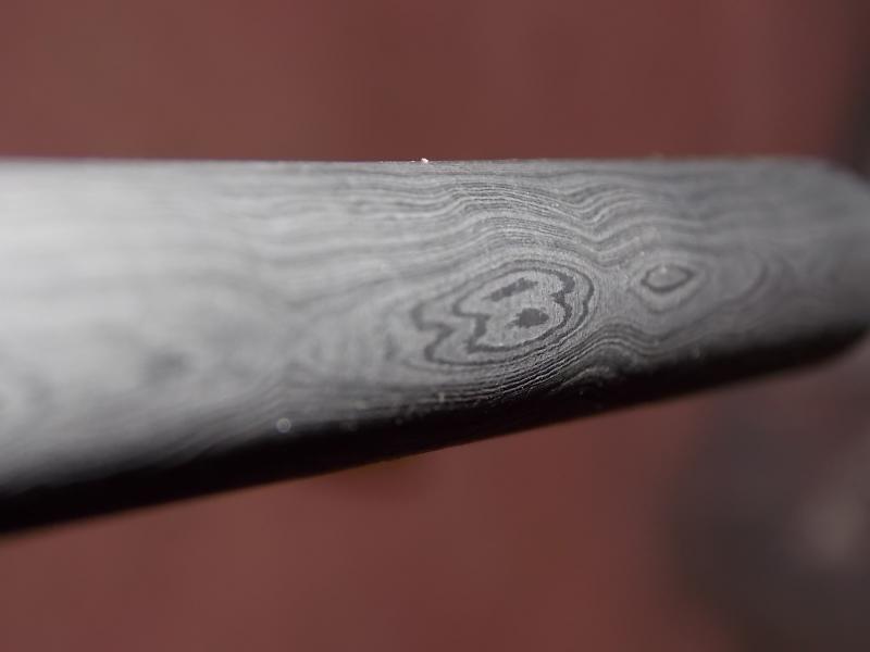

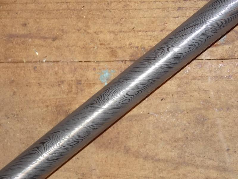

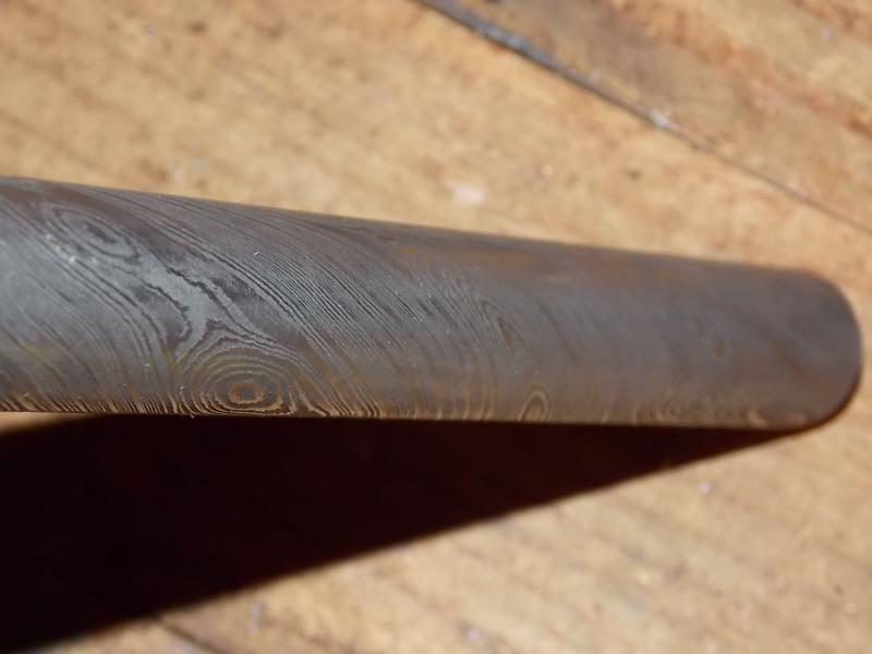

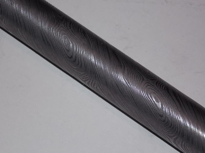

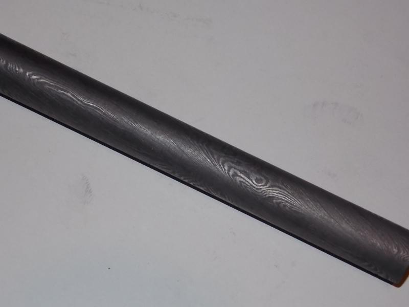

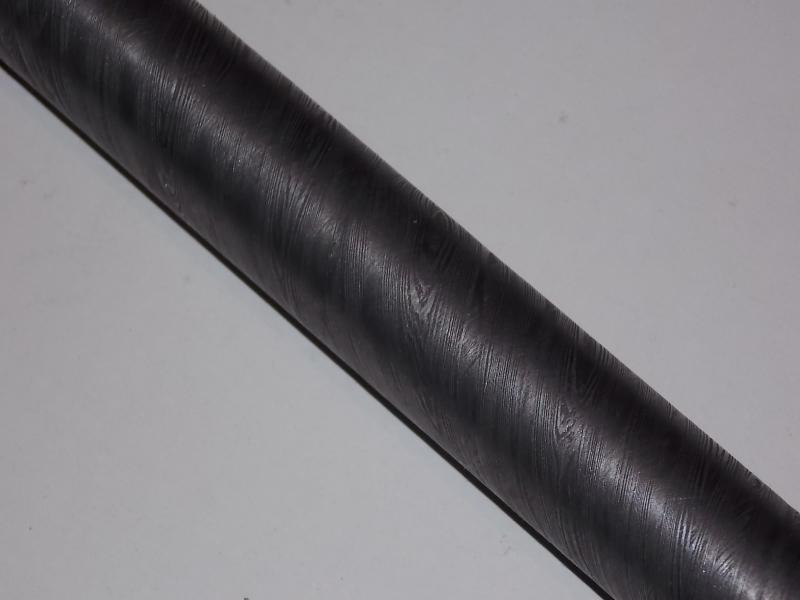

The first two pictures show the twisted pattern in the raw form
The third pic shows the straight stuff in the raw form
the fourth and fith picture shows what the twisted stull loods like turned....they still need to be etched.
the last picture is of another straight piece.
I will try to get some of the twisted pieces turned and etched within a week

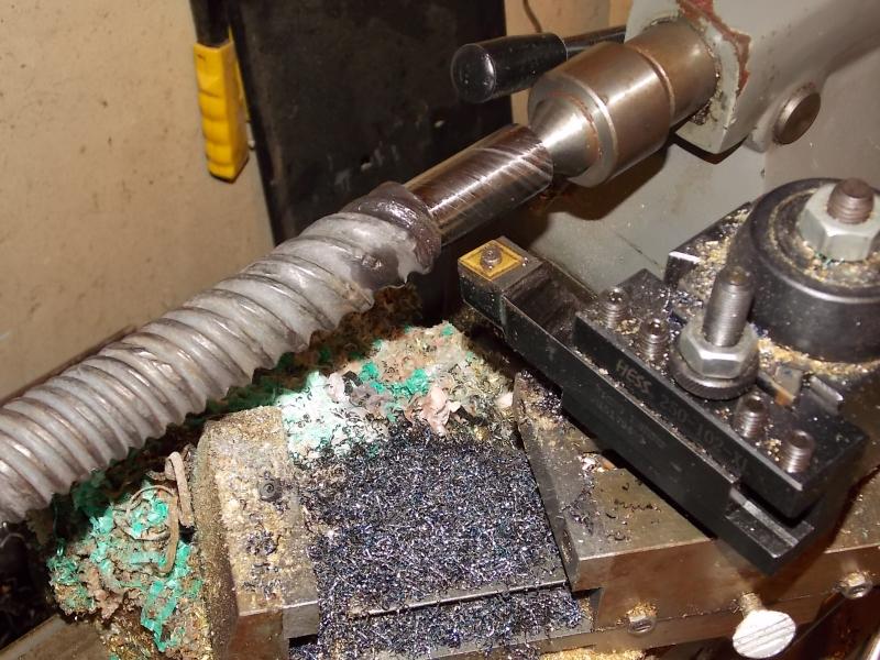

I am assuming that most people have mini lathes....If that is the case ....it may be hard for you to turn one of these down from the raw form, as they are about 1 3/16" in diameter....and they wouldn't fit though the spindle hole.
This is why I think It may be best for me to turn them all down to 3/4"....so that they will fit thought the though holes of most all lathes...I also may cut some into 3/4"x6" blanks.

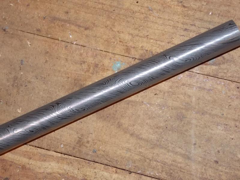

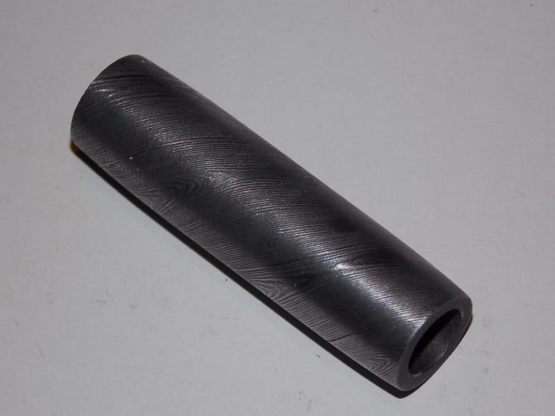

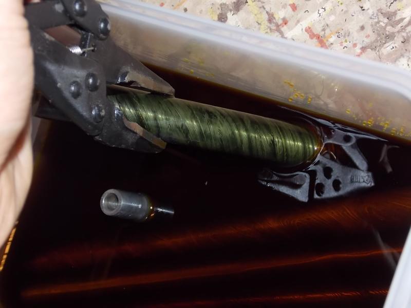

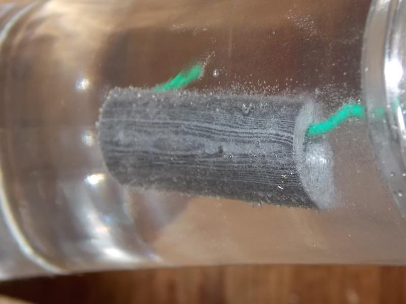

Here are a few pictures of these being etched in ferric chloride....I didnt sand and polish them as much as I should have...
I talked to my friend that made these bars....and he told be not to use ferric chloride....a little too late...
He said that I will get much better results using sulfuric acid....So I will do so later on tonight....
Later on tonight I will sand or turn these back down and this time etch them using sulfuric acid...

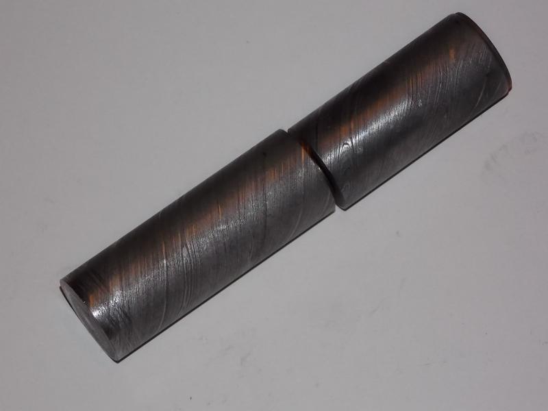

halfway down, and cut it to 6"
in length and it is about 7/8 in diameter DSCN1337.jpg
Then I etched it in ferric chloride...
I then put it on one of my lathes and let it dry....I should have polished them more so that they would have been brighter....I can still
This is just junk barrel for a majestic squire...that I made from a piece of scrap damascus......I should have pugged the end with wax so that no acid would get in the inside...
All of these seem it look pitted since I used the ferric chloride.
I will turn them back down a bit so that I can retched them using sulfuric acid this time...

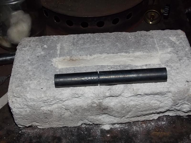

This piece came from a different batch...and it was super hard....so I annealed it...By heating it up to where it was cherry red. I then put it in this brick to cool off with anther brick like it on the top.
With this piece I will make a Jr series size..kitless closed end pen..
This one I will make a senior series size kitless pen with..

This piece came from a different batch...and it was super hard....so I annealed it...By heating it up to were it was cerry red and then put it in this brick to cool off with anther brick like it on the top.

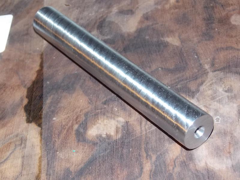

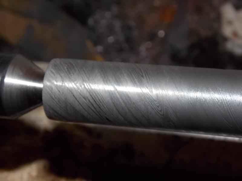

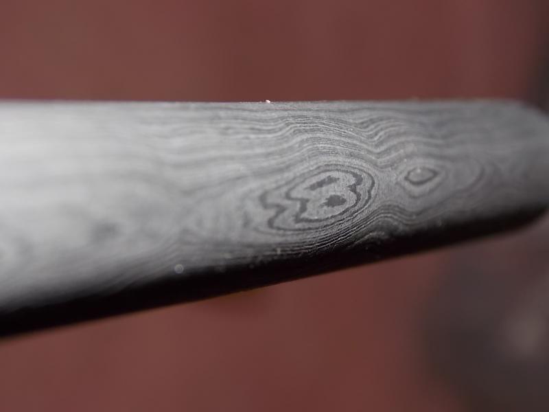

I tried the sulfuric acid, and here are the results.
I got to polish these more so that they shine more.
The only thing that I noticed different then the
ferric chloride. Is that too me it seems as if the ferric chloride pitted the steel, as the sulfuric acid didn't seems to.

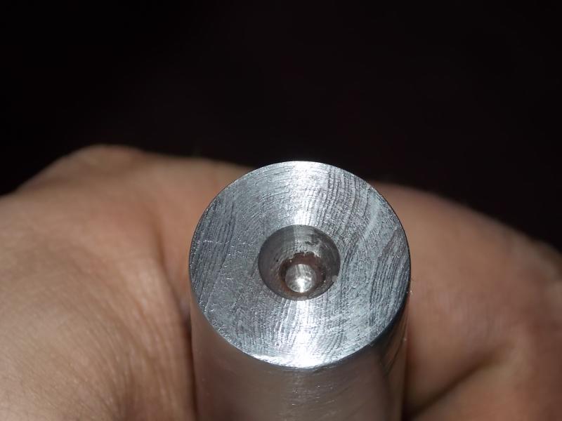

This right here is just a piece with a hole drilled thought it....It is not yet a barrel.

Pitting is often a result of the ratio being off, to long on solution. Can also be flaws in the welding as well. Could also be impurities in the metal and/or weld.
Some use lemon juice and most will repeat dipping 3 times for best results. Lemon juice will also remove scale.
Cold blue then a good buff on the highlights yields good contrast and colors.
Other things you can etch with, coffee, walnut, any/all fruit juices, etc..
After several searches on don fogg's site I did find several references to hydrogen embrittlement when using HCL.
