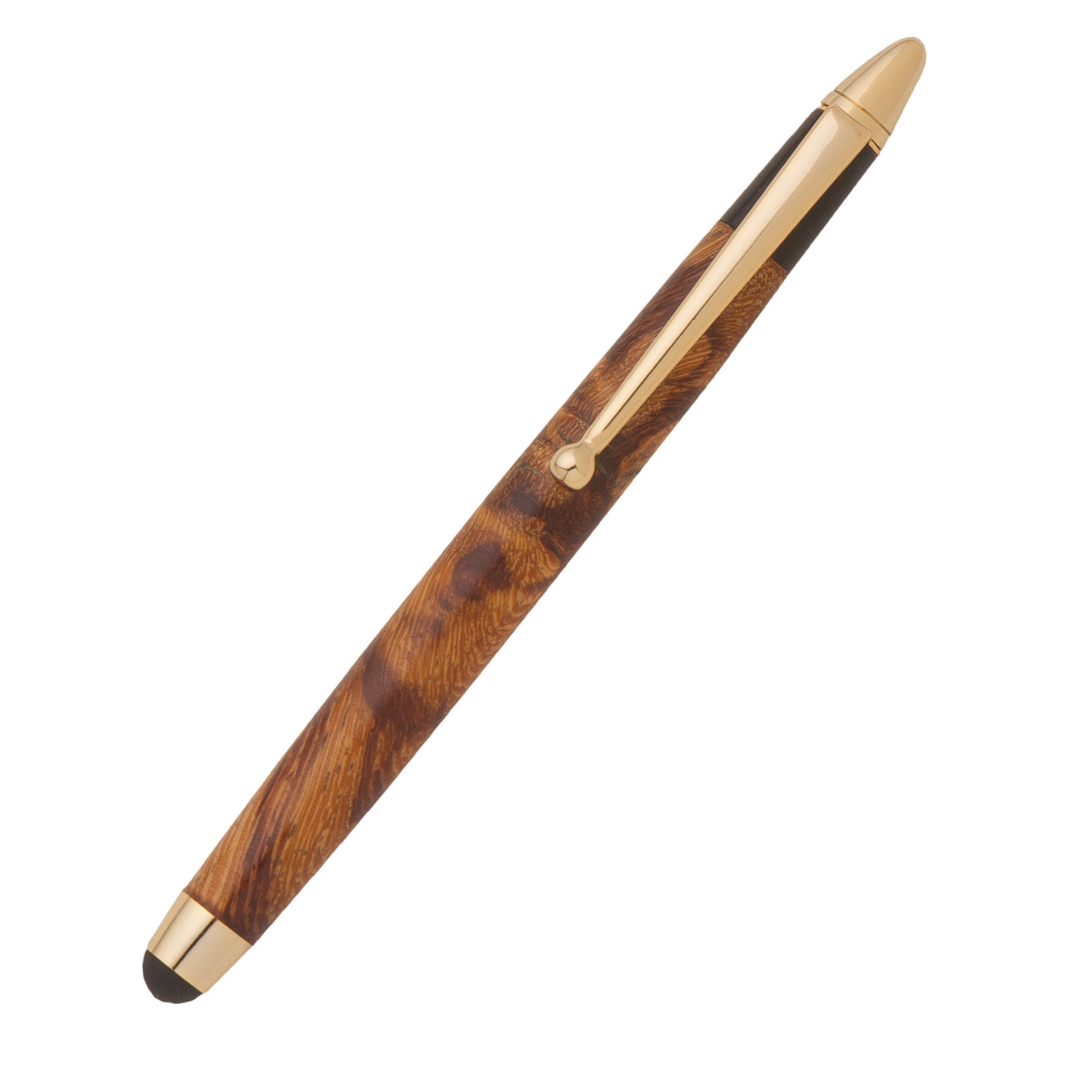

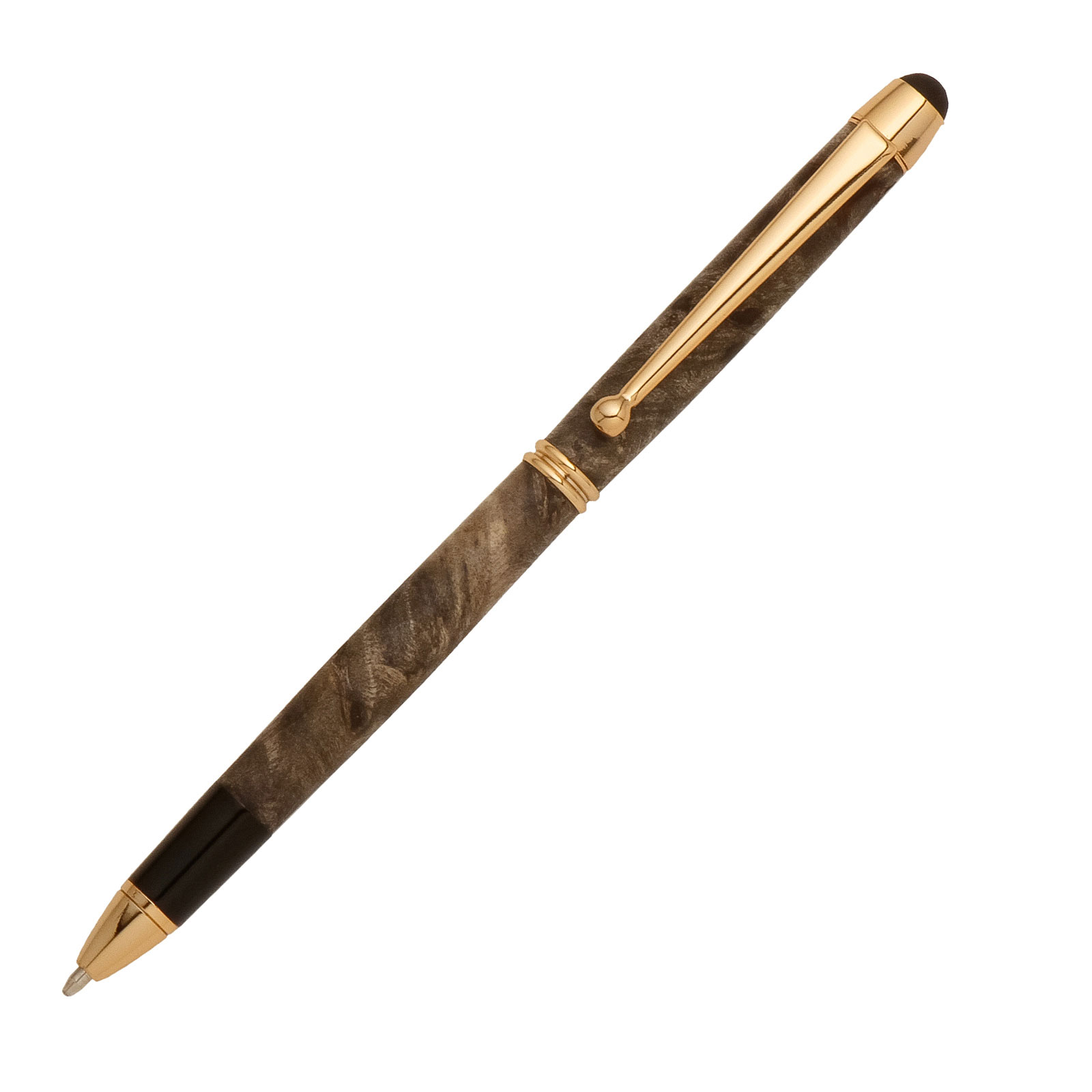

And, in a remarkable exhibition of how a free market and supply/demand function, PSI has answered our call! I saw this in the newest PSI catalog today and I'm incredibly excited to try it out! The fact that they have a model that is a pen on the other end is simply genius! Several plating options to choose from, as well.
http://www.pennstateind.com/store/PKTST24.html
http://www.pennstateind.com/store/PKTSPEN24.html

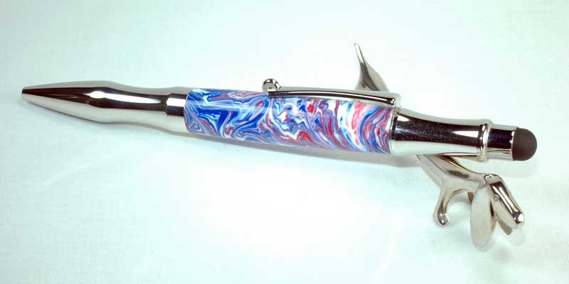

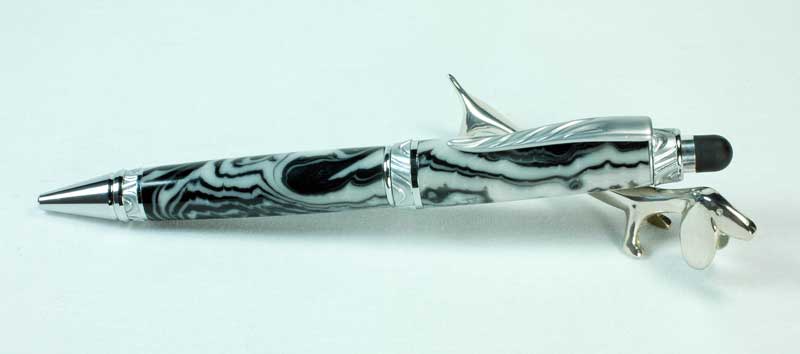

Here are a couple that I have done using the CSUSA stylus tip. It works very well.

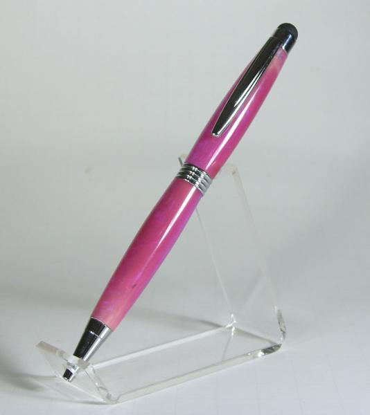

here is one of several Pen Stylus that will write. it has the capacitive silicon tip from CSUSA, and just about any 7 mm kit will work,. Several guys have done them in some nicer kits.
One advantage to this is it's Cross refill, which can be replaced with the Nylon styli for things other than the capacitive screen devices. I have done around a dozen and there is 1 in my display.
they sell well!!!
