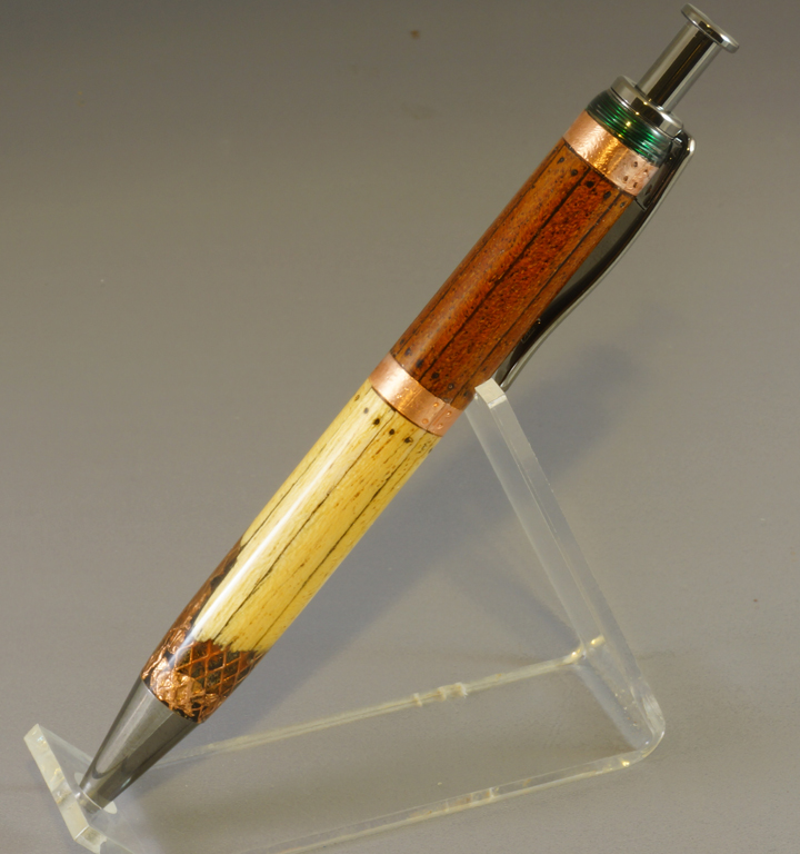

I've done something similar. I used wood strips from a wooden model boat. But I clear cast over it rather than build it with multiple layers.
BSea
Dec 28, 2009
4,628
Little Rock, Arkansas
Me, too. I have the pleasure of seeing it every day. Bob sent that beauty to me in a PITH.
Thanks Brian. I may have to make a sister of this one for myself.
The good thing about this method is that you don't have to account for the contour issue since the veneer is glued directly to the tube.

Actually, now that I remember what I did, the veneer is glued to walnut. It's a little more involved than what I posted earlier. Not difficult, but not just glueing strips to a tube either.
Phillip, if you don't have a pen of this quality, it's because you turn so many nice bowl, and lidded boxes. :wink:
