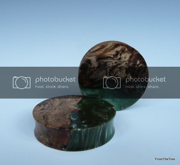

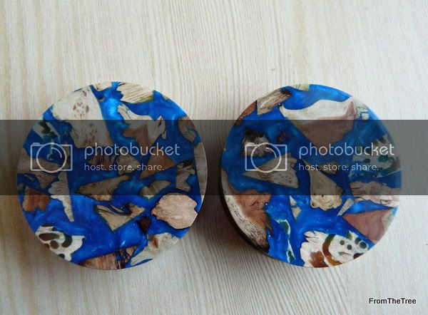

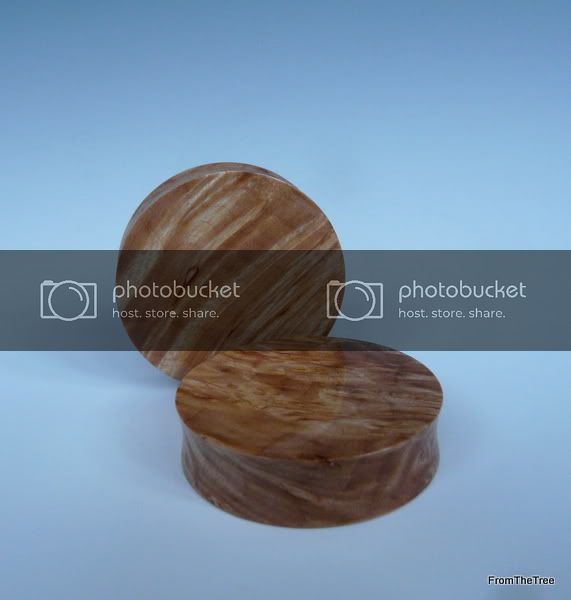

Hello- sorry a bit late to this thread but i make them too
I simply hold the stock in a chuck and do the concave saddle and one face then part them off and make a jam chuck to do the other face
these are all 2"
2" !!! Ouch....I always wonder what these folks will do when plugs are out of style yet they have large holes in their ears.....reminds me of some old National Geographic magazines I saw as a kid

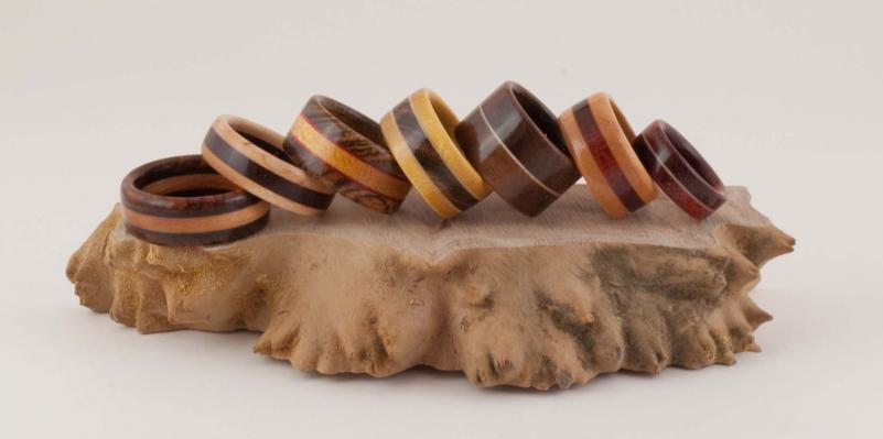

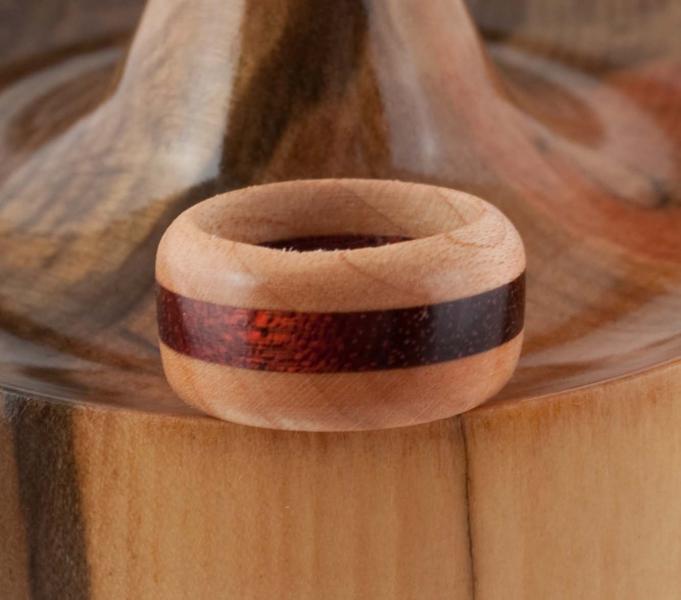

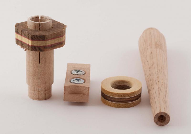

These are not much different than the rings I make.
I use a home made expanding chuck that I turned on my lathe from a scrap of hardwood.
The example is 3/4" OD on the fingers, but any diameter will do
I use the 60 degree live center to expand the "fingers" of the expanding chuck.
I make the rings a consistent size
Once round, I use some home made wooden jaws on my scroll chuck to hold the rings and turn the inside to the desired diameter.
The curve on the inside of the jaws was made with a Forstner bit to get good holding power. The ring blank OD matches the jaws at this point.
I then use the taper mandrel to hold the ring with a friction fit to turn the outside.

In my photo of tools, there is a wooden jaw. When I get home from work, I'll install the jaw set on a chuck, and take a photo of a ring being held in them
