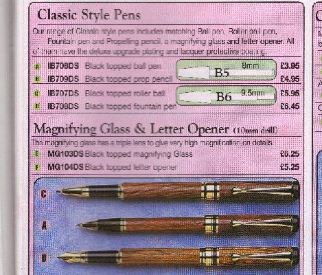

I recently acquired several rollerball and fountain pen kits. The label reads as follows:
The House of Woodturning
Craft Supplies Ltd
Derbyshire
The it has another label with the ShopSmith name on it and the following:
IB707DS Black Topped Classic Roller Ball
IB707DS Classic Stle Fountain Pen
I know Craft Supplies Ltd is in England. I went to their website and found the kits. There's information about the bit size and mandrel, but nothing about bushings or directions.
Anybody know where I can get bushings and the kit instructions?

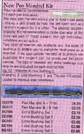

Ok, here's all I've got, not much I'm afraid[V]
The number IB707DS refers to the Black top rollerball
The fountain pen is IB708DS.
In the catalogue, both take 'B' mandrel and '6' bushings using a 9.5mm drill.
The bushings set are listed as part SG197 and cost £3.95
The 'B' mandrel is just an 8mm mandrel.
If you send them an e-mail, you might get lucky and they will measure the bushings for you. I have bought loads of stuff from them, but they can be a bit slow answering e-mails.
I use homemade conical bushes and mic my pens to each kit.
Hope this has helped
When I checked the website they quote
"This Black Top Fountain Pen makes and excellent addition to your desktop. Requires 7mm Pen Mandrel, Mandrel Sleeve #A (SG192) and 9mm drill bit to complete. Make a matching set with either a Roller Ball Pen (IB707DS) or Ball Point Pen (IB706DS). "
Best to mic the tubes. I have made these pens before but I can't remember what drill they need. They go together really easily - lay the parts out and have a look.

Here is a scan of the CSUK catalogue.
Richard's info from the site is also correct. Tell you what, send them back to the UK and Richard and I will split them!![:D]
