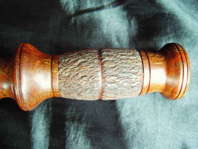

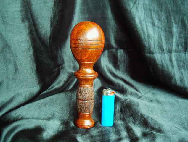

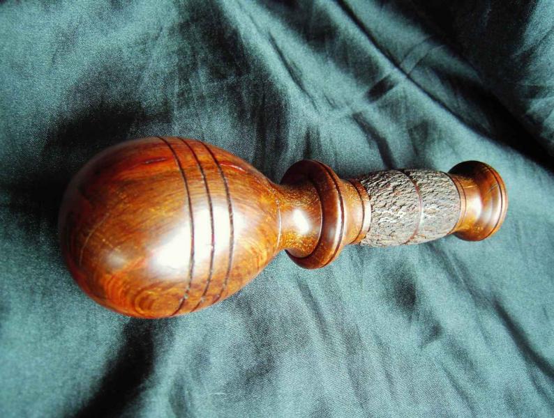

Basically an egg with a handle, but I'm wondering whether it's best to do it in two pieces, one piece, what finish to use, if any particular wood works best, etc.
Oh yeah...! I've done plenty of that and had to do it right, no bumps on the socks...!:eek::redface:
We had a river next to the house and "polished" river stones were abundant so, we had a couple to work with...!
Actually, a couple of years or so, I had someone asking me if I could make one as a present to his Mum, as she moved to Australia from the UK to live here and left her's very old one, behind somewhere.
It was also a good opportunity for me to use one of my preferred local woods, the aged She/Bull-Oak, and turn something I haven't seen for a long time...!
I reckon it did turn our OK, huh...???
