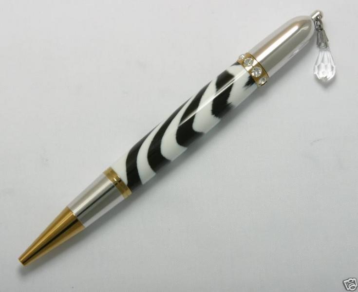

I would agree. I could do without the charm on the end, which came off when I removed it from the package. So far I have only made one, though I have a few others waiting to be turned.
