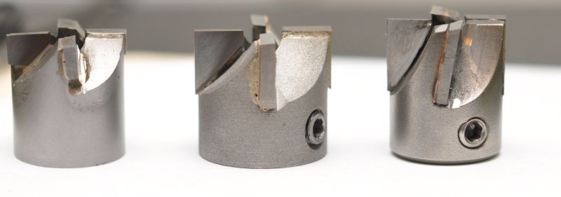

Last year I had the opportunity to give my pen mill for honing here in Greece. The job was well done for, with this hell of a tool, I was even able to perfectly clean my pen blanks (believe me or not...) after finishing them with CA! Meanwhile, I tried to order a new carbide pen mill from different sources. After some unsuccessful attempts and a poorly made pen mill (3d on the right with positive rake) I found a firm here in Greece which IMHO will be able to make carbide pen mills to our specifications.
I already ordered two units from them and a fast test (with a spalted beech blank) produced some interesting results. These units were made from scratch, that is I didn't provide the mills. The mill's diameter is 7/8" (22mm) and the welded carbide cutters have a neutral rake.
On the pic hereunder the first pen mill (left) is my Nolan's one (a hell of a tool!!!) with negative rake cutters, the second one (center) is one of the pen mills made by the Greek firm (neutral rake) and the last (right) is a pen mill, with positive rake, made by a Belgian firm.
The question is, is there any interest for this kind of carbide pen mills? I have to meet the person in charge at the end of August but he already told me they can make this kind of mills either from scratch (to our specifications with neutral or negative rake, at the diameter we want...) either by welding the carbide cutters to mills we'll provide.

I have 3 of Nolan's mills. One of his originals and 2 latter. The original has a neutral rake. A latter generation a very slight rake and the last even more rake. I find I like the neutral the best a very slight rake mite be better and more forgiving for a wider range of users. One thing to point out is quality control and this is nit picking. out of the 3 mills I own I think only 1 is spot on as far as the level of the cutting heads. The others there is 1 or 2 the are slightly higher. We're only talking thousands but a way to check is to simply put the head on a flat piece of steel and see if there is a wobble or light showing under a cutter or use the mill by hand to clean up a finish blank and see if one of the cutters is doing the cutting or is the cutting shared by all the cutters.

I agree with you Bruce a slight neg. rake would work for most and I was lucky as all three of mine were nice and level (according to Paul in OKC).
I think that as these will be made from scratch instead of having the cutters added to existing mills that the levelness of the cutting heads would be easier to obtain.

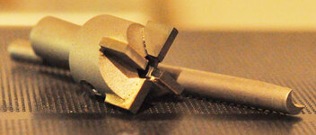

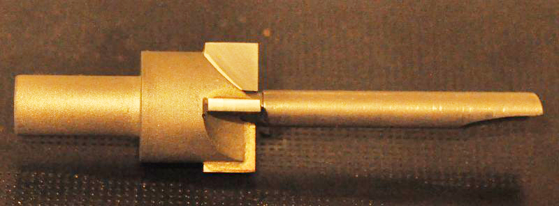

I don't know if there is any interest. Anyway, at the end of this month, if some colleagues are interested to purchase such a tool at the introductory price, I have a couple of tools for the first 10 respondents so they can try (under certain conditions) these tools before making any decision. One of these tools is mine and the second is provided by the factory in order for us to try their new design. As you can see (pic below), the mill's shaft is part of the head.
PS: the mills made by this factory have a slightly negative rake at -1°.
